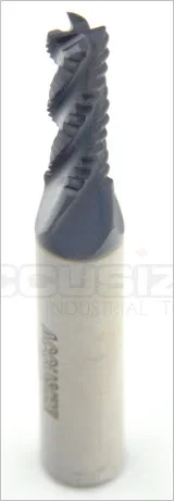

I discovered something as I was making a rather intricate part the other day. Thankfully I did not botch it, but it was skinny close. Turns out a 1/4" (=0.250") diameter fine tooth roughing end mill (happens to be Accusize brand) measures 0.255-0.256" in actual diameter. I was doing work on a rotary table where I was offsetting by a radius using DRO. I gave myself what thought was a healthy allowance to clean up to final dimension with a regular end mill after the rougher. Only to discover the regular end mill was cutting air because it was 'on spec' at 0.250" +/- 0.001" I haven't gone back to check my other rougher EM's but might explain a few past mysteries I had chocked up to setup.
Anyone else experience this diameter discrepancy with brand name roughing end mills? I just naively assumed they would be pretty close to reference size.

You would think that they would be close, I have noticed that they can be a couple thou over though. Mine has the probe and tool measuring on it I'll have to get a roughing end mill and try it.
At my day job I handle hundreds of brand name endmills every month. All of them from Kanametal, Sandvik, Harvey tool and Widia. I have never seen one oversize but often they come in as much as -.001". These company's listed have good quality control and wouldn't let tooling leave the factory without being checked. Accusize is a company that does most of its business online because the quality isn't good enough for manufacturing community to endorse. That being said I have a few accusize tools in my garage but I'm just a hobbyist when I'm experimenting at home.
I got a similar response on another forum. Basically if it doesn't have a ANSI/ISO/whatever rating that prescribes tolerance (which they don't), then basically it can be anything. They cut reasonably well & price wasn't too bad. So the moral of the story is: don't assume, measure the cutter OD!
