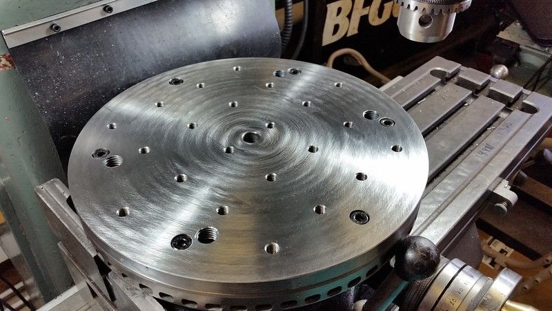

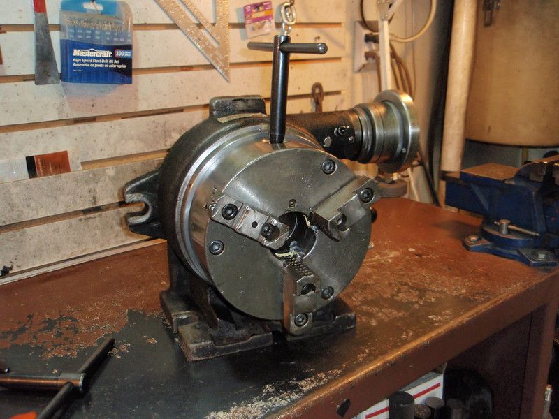

They make it sound fantastic. It will be interesting to see what the quality is like if you do order one. A tail stock is a fairly easy build considering what they sell for. I got lucky when I found my 8" Vertex Super Spacer used on Kijiji. It was pretty crusty but cleaned up easily and is super accurate. A super spacer is just a rotary table without the table and has a chuck mounted instead.i fabricated a table that can be mounted when the chuck is removed. I'm glad I got the 8" model as the size comes in handy but it's a heavy brute at 175 pounds with the chuck. I don't have dividing plates and although they would make some jobs faster I haven't found a job I couldn't do without them. I paid $200 which I thought was high at the time but just the chuck is worth more than that. Those deals come along once and a while if you are patient, I was just about ready to order an Indian made one when I found the Vertex.

After my chuck/RT centering episode, I view super spacers differently now. I might be wrong but I think you are locked into whatever the jaws deliver concentricity wise. At east with RT you can bolt on different chucks & adapter or irregular parts & adjust concentricity. Maybe super spacers are built tighter standards & that's why they cost more? Anyway, even the small ones can get pretty tall & also heavy.

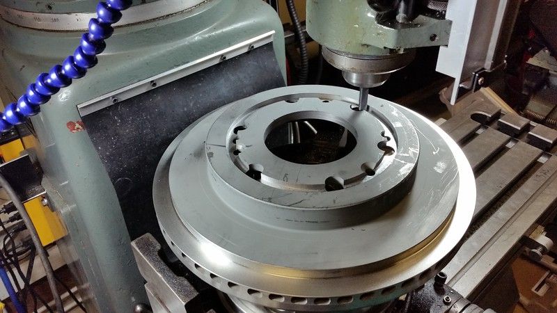

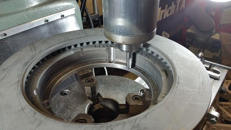

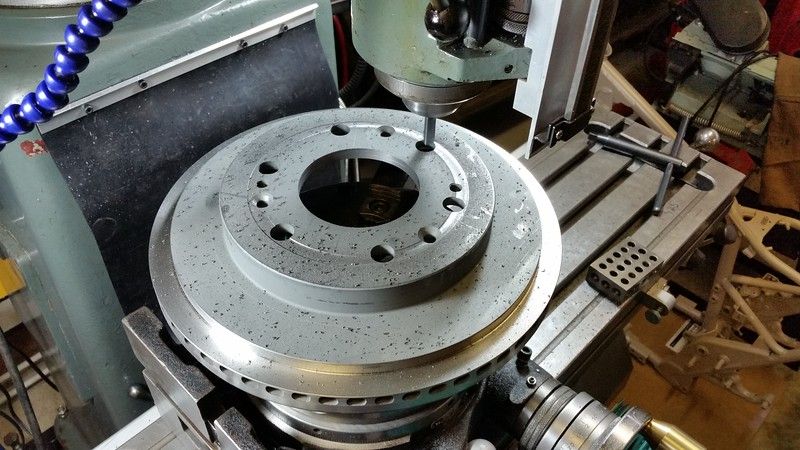

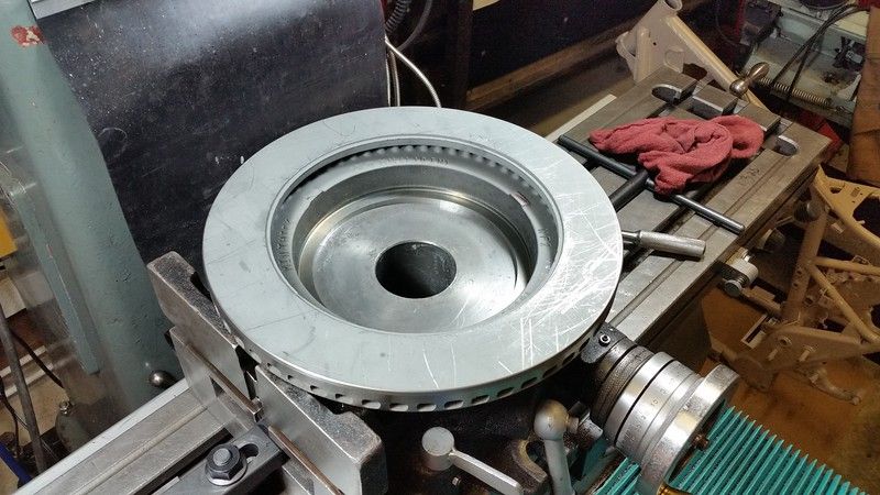

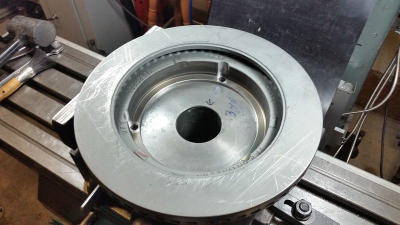

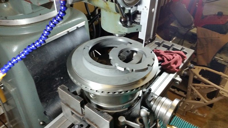

I have checked the runout on my super spacer a few times with different size items in the chuck and it is less than .001" consistently. I don't know if they are all that way but I'm happy with it. You're right Peter, it is very tall and that was a problem with my small PM932 mill but not so much of an issue with the Ferro 10" X 50" mill. I built a table for it from a piece of 5/8" thick 12" round plate that I got for free from a buddy and a new 12" car brake rotor.
It looks like this with the chuck removed.

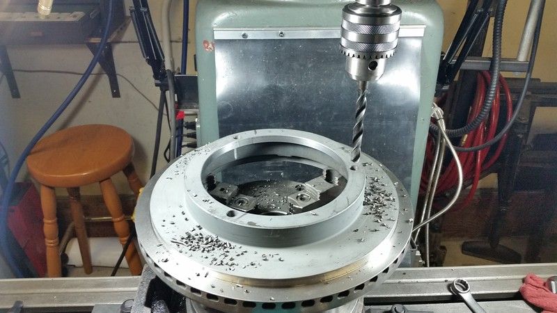

I machined the center out of the brake rotor to fit the centre hub of the super spacer and drilled the 3 mounting holes to mount it.
I also have a shop built simple indexer with a 4" chuck that has positive stops each 10 degrees. The chuck is mounted to a car wheel hub which is bolted to another brake rotor and can be mounted to my 9" angle plate. I actually use it more than the super spacer.

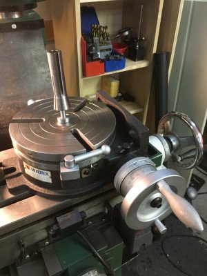

I bought the vertex 8”. It was pricey but it’s very nice. I use toms machining technique to center it with an adapter in the spindle. Pull down into the hole, align, and clamp. Works.
Now I need to Cnc it...
Here’s the adapter and the table..

I use that method too. Actually, I was too lazy to machine a special plug adapter because I found an MT3 -> straight segment arbour blank. They are dirt cheap & very accurate. Put the straight segment into your collet & 'plug in' the MT3 section just like he shows. One thing I found is be very careful as you tighten the nuts on RT centered like this because its easy to build in side force on the now loaded spindle due to twisting motion of nuts. Somebody told me its better to use ?what are they called? kind of a thrust washer concept.

Guy Lautard in one of his bedside readers has some tips for Rotary Table use using tools that screw into a M.T. spud inserted into the tables center hole. I cut the taper off a M.T.#3 drill bit for the basis of mine.
