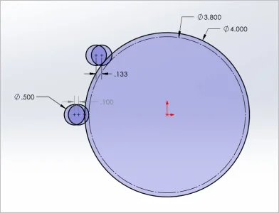

So I have my first project using my rotary table and I have a set-up question:
I will be turning the outer hub of a brake disk to be used as a mounting pillar for a telescope. (Surface "A" in the picture)
I am thinking it doesn't matter if the table is centered, as I will move the piece into the tool, and then simply rotate the table. The table won't move in relation to the tool, except around it's centre axis, so it will take the same amount of material off all the way around the part.
What I will need to do (carefully) is centre the part on the table so I don't end up with some sort of eclipse.
Am I right, or am I missing something?
Thanks in advance!
Tom

I assume you are planning to mount the RT horizontally on the mill table? The RT will have to be centered under the spindle and the part centered on the RT (i.e. the spindle).
Sure looks like a job for the face plate on your lathe to me. Setup time on the RT or face plate will probably be about the same with the lathe producing better results.
Are you sure you can't grab it from behind with the outside jaws of your 3J lathe chuck?

Good replies previously. This would be a good job for a lathe but if that's not an option a milling machine will do. One thing to keep in mind is that the cutter will impart rotational torque on the RT so make sure your setup is really solid and that your RT can handle the torque.
You sure you don't know somebody with a big enough lathe for that job........
If you are hell bent to use your mill, I don't think you need the table precisely located. You just need the disc precisely centered on the table.

I think you definitely must have the brake rotor centered on the rotary table, or you are going to end up making that center hub into an eccentric relative to the other round parts

Unlike the other more experienced responders, I think you are correct. The distance between the center of the table/center of the workpiece and the mill spindle/cutting tool won't change if the workpiece is centered on the rotary table.
I think you are misreading the "more experienced users". By my read, they all agree with you. I certainly do. My own only caveat is that the work must be centered on the axis of the ROTARY table. I don't really care where the rotary table is located on the table.

When I wrote my description of setting up my rotary table I made an assumption that may not be valid.
That Tomc938 has a 3 jaw chuck mounted on the rotary table. If there is no chuck then the brake disk will be bolted directly to the table.
So then it just become an exercise on aligning the disk onto the table. Doesn't matter where the rotary table sits. Just spin it around with a dial on it until the deflection is within whatever tolerance is desired.
Now if there are a number of holes that need to be drilled relative to the center of the disk, for mounting the telescope for example, then you still need to figure out where to put them. It's easiest to already have the rotary table aligned with the spindle at 0,0. Then if you want 4 holes on a 3" radius just move over 3" and drill the first. Rotate table 90 degrees and drill the next. Rinse and repeat.
It really all depends on the precision required. My tapered tool for my rotary table just makes a lot of those things really easy.
There is a somewhat practical reason for pre-centering the RT to spindle X&Y beforehand even though it may not seem to matter initially. More than likely you will be advancing the cutter in one of the mill table X or Y directions, progressively in-feeding until you achieve a target diameter. If your cutter is off in space, it will require doing some math to compute how much table movement equates to actual diameter as you converge to the target dimension. Hopefully sketch makes sense. Note the 2 different dimensions to achieve the same resultant diameter.
