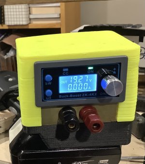

In the mean time, I noticed that you used a Makita 18v Tool battery. My big 8" Meade LX200 telescope is also 18V, so I did the same thing. But I didn't make a 3d printed connector. I just bought their cheapest 18V tool. It happened to be a flashlight. I ripped it apart, made an epoxy plug lid for it that included a regular 2 pin socket, and it has worked great ever since.
@Susquatch I ran across the 3d part on thingiverse. The makita connector part # was listed so I ordered a couple. IIRC it was just over $10. Here’s a picture of my power supply now.
