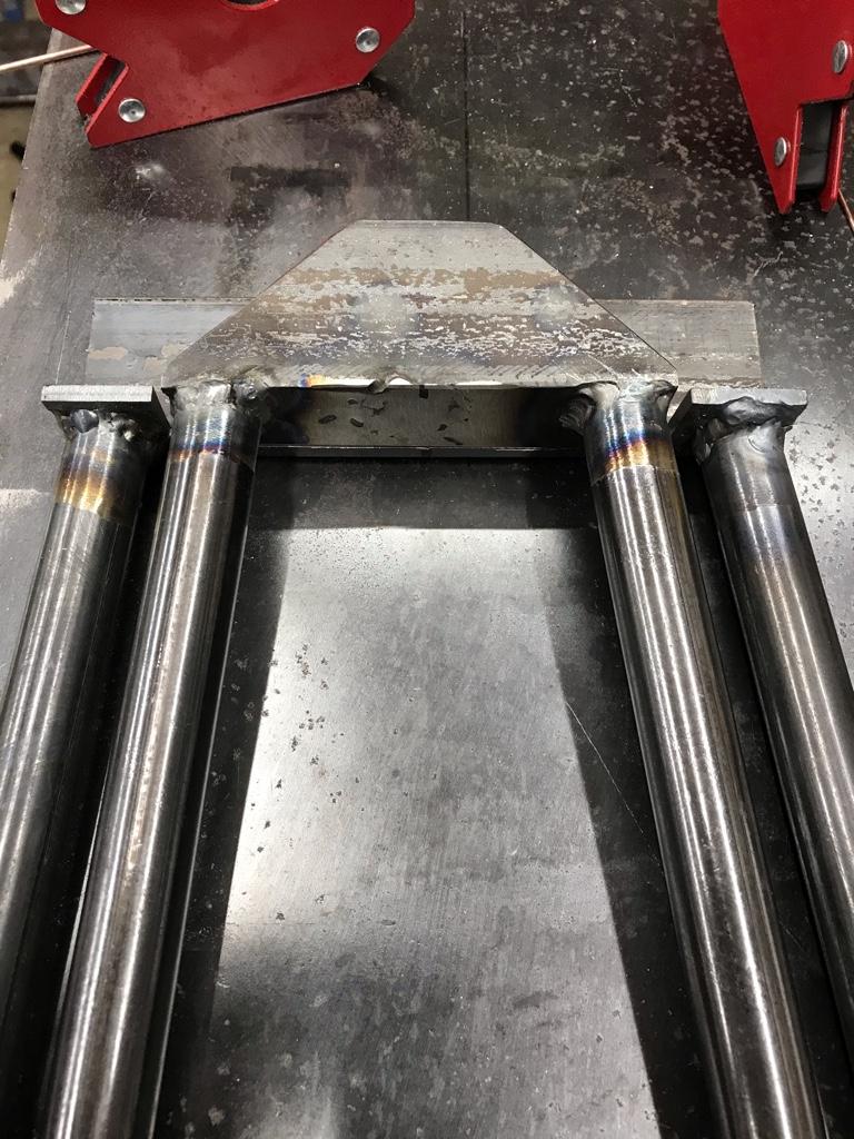

I started building the head alignment guide for my RF mill today.

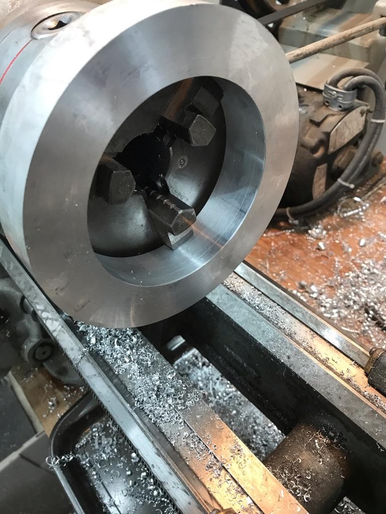

I sourced a piece of 6” diameter 6061 yesterday and today I faced both sides in the 4-jaw.
I hoped to bore it out but got too cold and hungry [emoji39]

Major progress today.
Bored it to size.

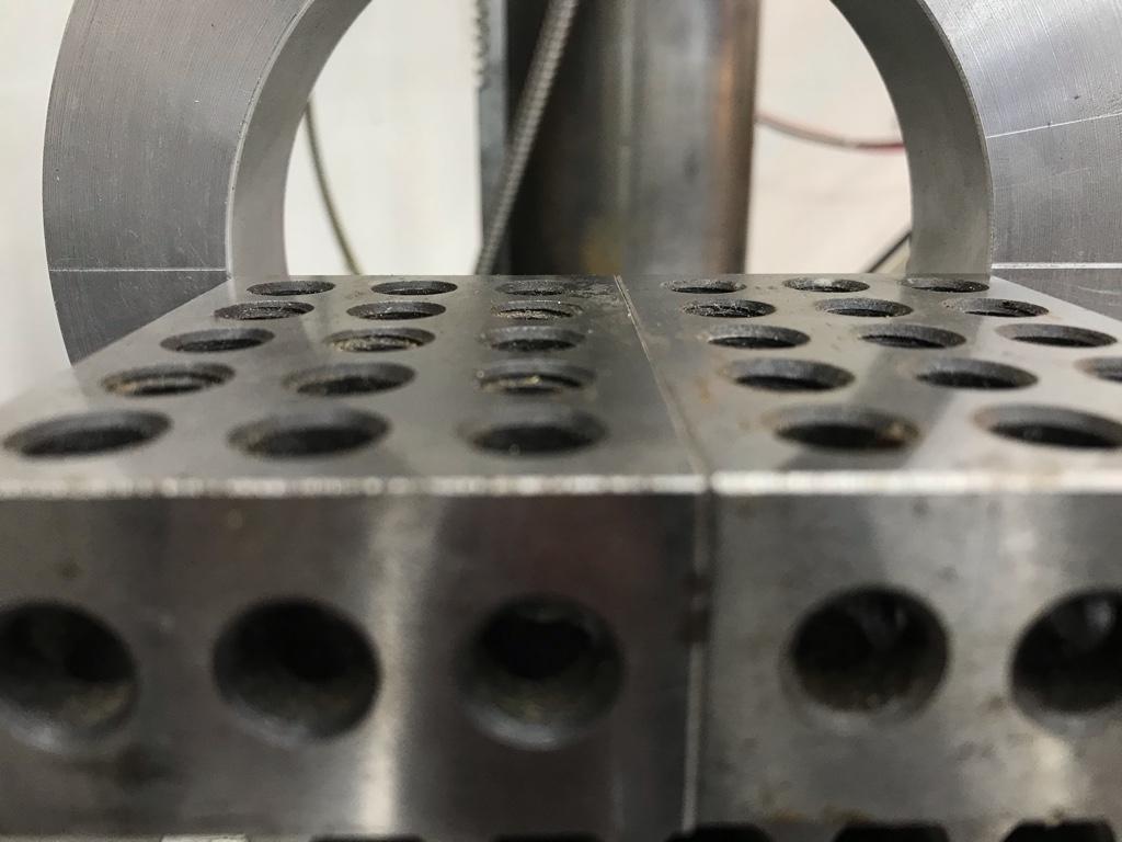

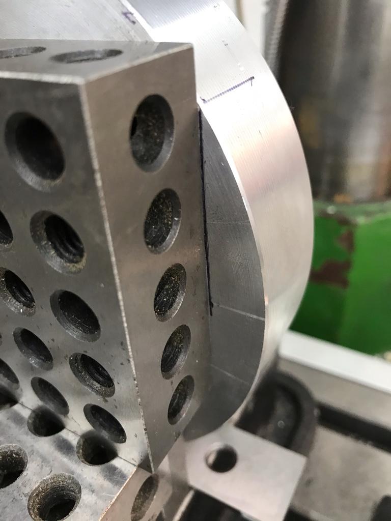

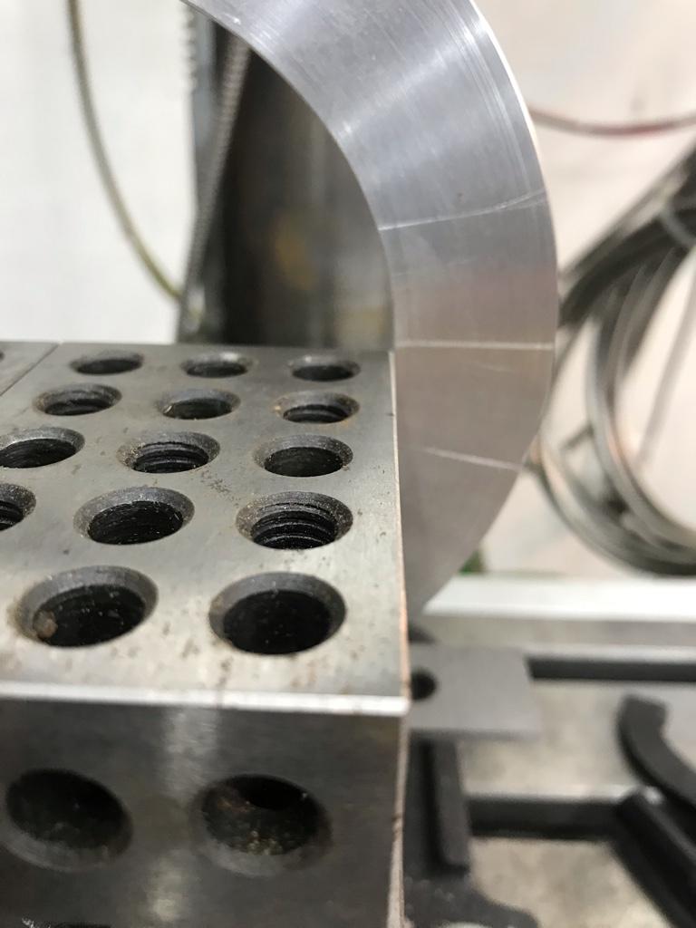

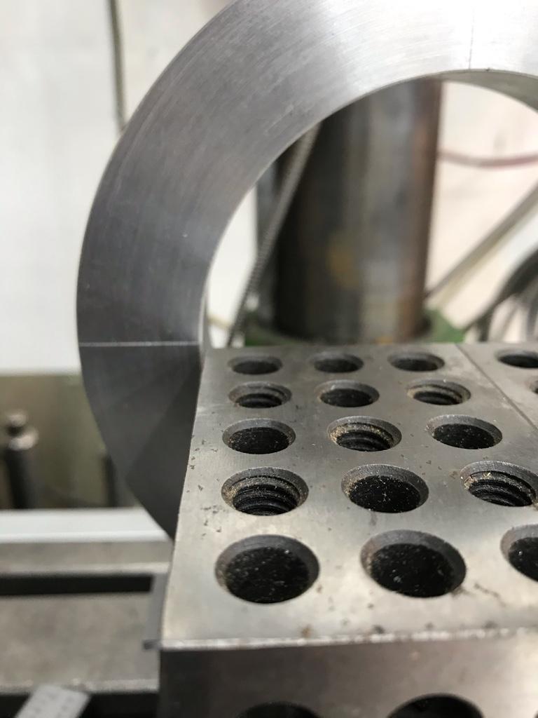

Fitted it up in the mill with a parallel on it face underneath so that the scribed centre line cleared a pair of 1-2-3 blocks on the vise. Using these as references I levelled the ring.
I marked the centre of the ring rim and drew a vertical line amd extended it across the top as a reference for the end mill.

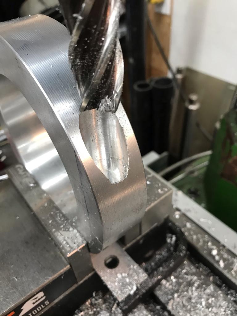

Used a center finder and my DRO to find the centre of the thickness and bored the countersink holes for the 1/2-20 cap screws that will hold the two halves together.
What are you using for a boring bar?
I did it in three stages:
1) used a 3" hole saw to remove the majority
2) ground a 3/8"HSS blank so that it had side clearance and put it in my boring bar tool holder. Ran that in straight taking 1/8" DOC at a time. Feed rate was .0027/rev. Slow going but 1/8" better than I could do with the boring bar.
3) used my SCLCR boring bar to make the finish passes.
Took today off to run errands and get in a little shop time.

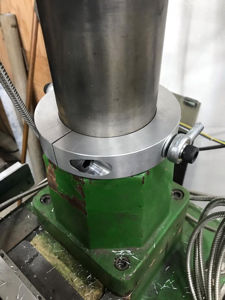

Finished the collar for the mill.

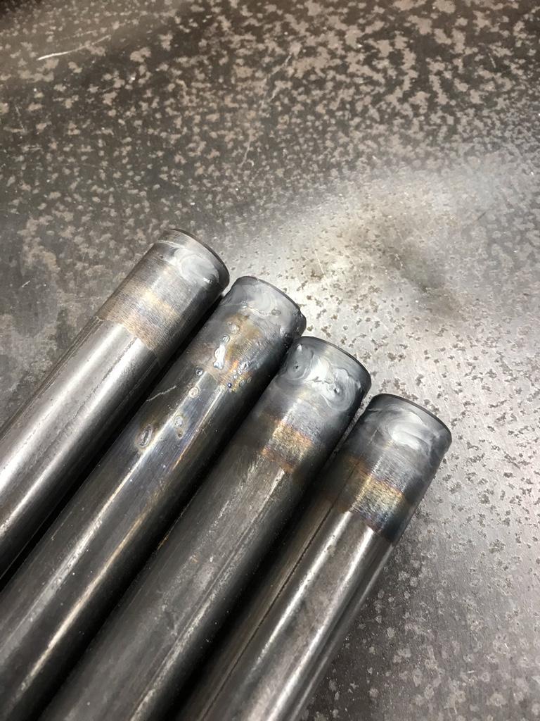

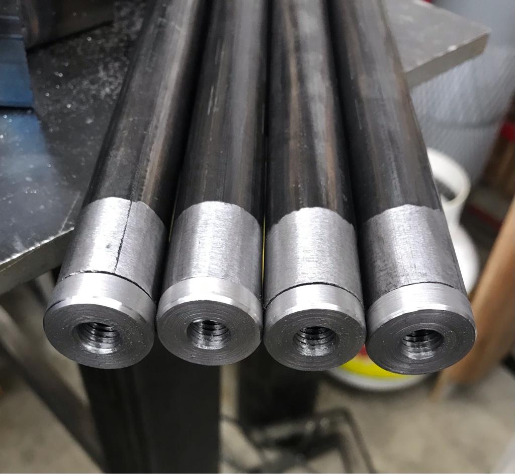

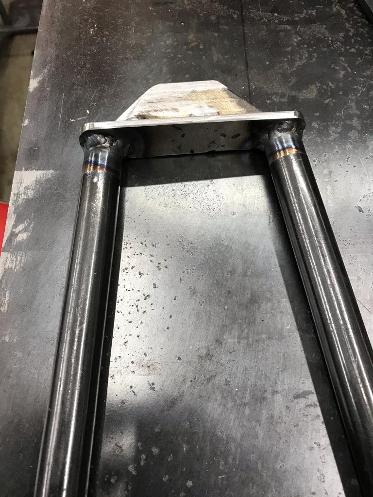

Made up the four plugs for the stabilizer tubes. All set to be TIG welded on.

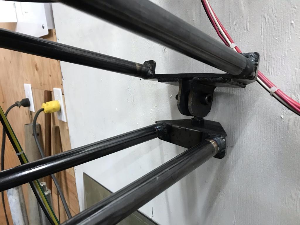

More progress.
TIGed the bungs into the pipes.
Cut the brackets and TIGed the pipes onto them.

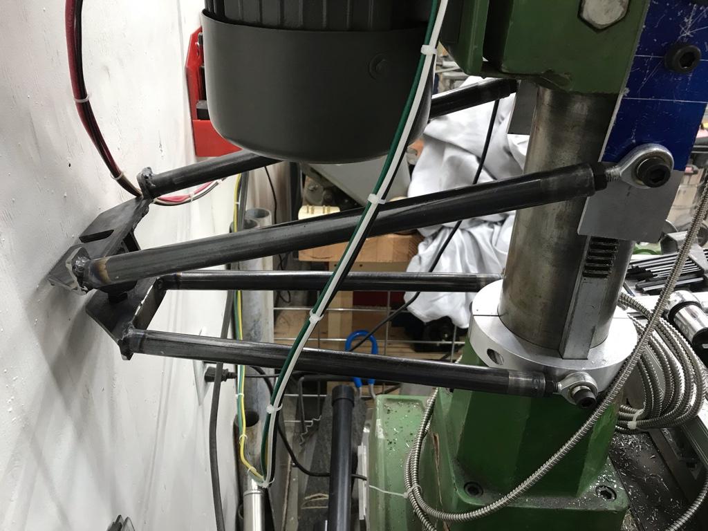

Finished assembling the parts yesterday.
Works very well.
Interesting set up (in a good way).
Are you sure someones race car isn't missing some suspension parts. ;)

Thanks Pete, I appreciate the positive feedback.
I cannot take any credit for the design, it’s a semi-faithful copy of a design I saw on Hobby-Machinists.com.
It is more elegant than any design I’ve seen. And was dead cheap to build.
I had the angle iron and aluminum plate.
$30 for the aluminum round for the column collar.
$25 for the iron pipe
$13 for the heim joints
$10 for the hardware
All in, $80 :)

I think that there needs to be means for the arms to adjust to raising and lowering the table.
Because the table doesn’t have near the same mass or forces acting on it I could see a somewhat simpler setup working well.
Sometimes I read/look at something 50 times and I just don't get it. This is one of those times. I read the link you sent, and I went over your pictures many times -- drawing a blank.
What alignment issue/challenge are you trying to solve and how does this help (how do you use it)?

If you have to raise the head on a round column mill it’s impossible to maintain X-Y position because the head is free to rotate around the column just like the table on a drill press when it’s raised or lowered.
This setup prevents the head from rotating as it’s raised or lowered.
