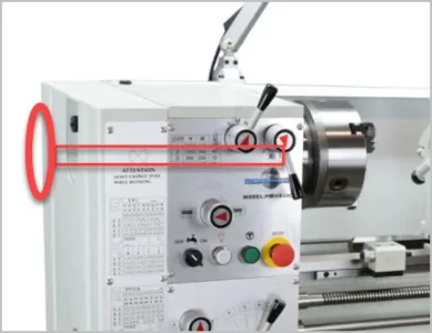

You mean something like this? Drawbar goes through the spindle tube & gets tightened with some sort of wheel on LHS of head stock?
Precisely.
IIRC a drawbar and adapter can be used on lathes that have a MT4.5 or larger. Of course the spindle bore also matters. You'd have to have enough meat on your drawbar to machine internal thread and still have tensile strength
