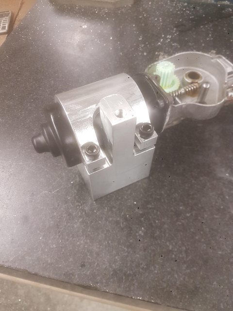

Nice Job tmate.
I just scrapped 2 cars last weekend and grabbed the wiper motors out of both of them before they went (among a few other items to be repurposed). I had planned on using one for a welding positioner eventually too. They're great little motors. Never thought to use a drill press frame though, I like that idea. Thanks for sharing.

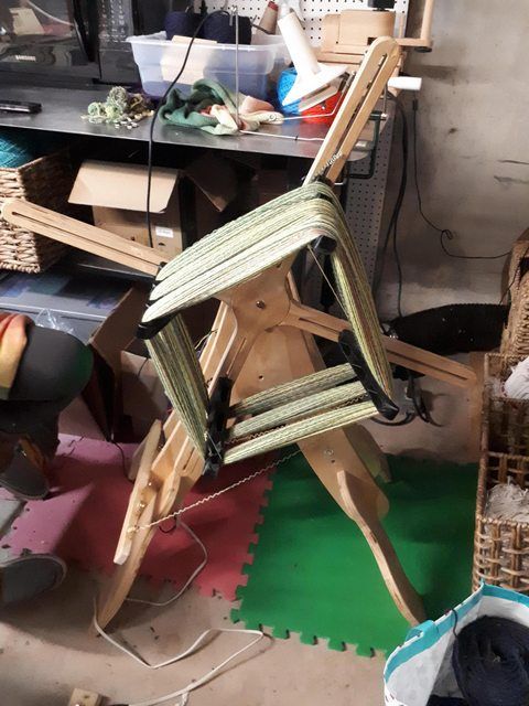

Dan Dubeau
Love the history. I really enjoyed your thread over on PM.
I used a modified Pontiac G6 wiper motor to power the skein winder I built for my wife a few years ago. Handy little things.
Still waiting for my first order, but it should catch on like the Torchmate any day now.....;)
That reminds me, I still need to finish the arduino controller for yardage, etc.
