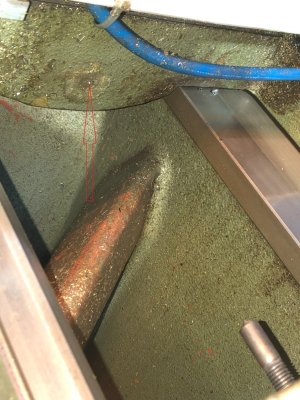

Last year, I added a cushion column to the tailseat, made of tetrafluoroethylene, which provides a soft cushion when the tailseat comes into contact with the large trailer. Why do manufacturers ignore the harm of such hard contact in their designs?
Does your lathe tailstock have a rough collision with a large tractor during the push process? What is the quantity? Is this a negligible problem?

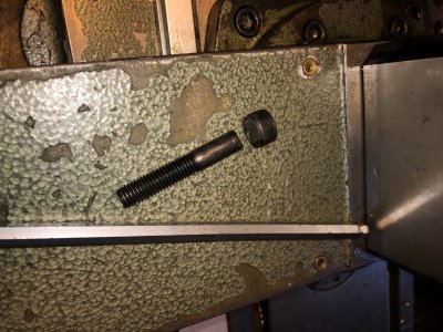

Today I removed the cushioning cylinder, took an M10 screw, cut off the inner six cup heads, and lathed a sharp corner to make a positioning punch.
Install into the threaded hole and then strike a positioning hole with the appropriate force.
Use an electric hand drill to drill holes
The tap makes the internal thread
And then I draw on the computer, and I won't have the results until about tomorrow

I think I made a fatal mistake: positioning the tip of the cone without adjusting the verticality caused the center to deviate by 2mm

I think "double whammy" is a good illustration of my current situation. After I make a simple mistake, I inevitably get a more serious one.
Because of repunching, I punched through the cable channel of the big drag board, which caused the control cable to break some, and re-purchased the cable to replace it today.
