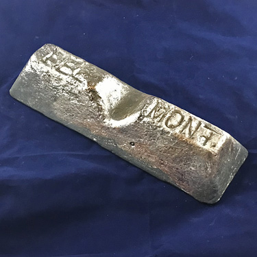

I am looking for casting nuggets/ingots not rod/hex/tube/flat-bar. I actually called those folks, the gentleman I spoke with had no understanding of casting material. Do you have a source for nuggets or ingots ? Like this but in Canada :

Phone Inproheat in Edmonton, and see what they have to say. They supplied a bunch of the foundries doing Art Casting out near Regina, and while they mainly dealt with the big plants, they also were not willing to tell the small buyers to get lost! The carried various Bronze alloys for casting, and if they could get those, they will know who to talk to for other alloys.
I kinda doubt you will find anyone selling smaller than some pretty large qty's of casting nuggets or shot, without you paying way over the odds for it at a Jewellery making supply house, probably in 1 pound jars, if not ounce baggies.
