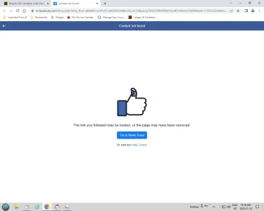

After more money and time than I care to think about this 25# Little Giant power hammer is back to work. The addition of the brake on the flywheel is a real perk as it gives the smith a lot more control of the ram and eliminates the infamous double tap these machines are known for.

You are right, it would be very foolhardy to operate the hammer without a barrier between you and the spring. I took the picture with the shield off to show the rework that was needed to get the hammer running again. Essentially, I had to replace the pitman link and the toggle arms and links. The pitman pin on the flywheel needed to be modified (broke my heart). I refurbished the ram by boring out the pin holes in the lugs and welding in bushings. One of the lugs was in such bad condition that I cut it off and welded on a new one. The motor and motor mount was replaced and a start switch was added. Then once the hammer was running I realized that the hammer dies were so badly worn that it was impossible to time the hammer, so I machined new dies from 4140 and "heat treated" them. Beyond that, I added a strap brake around the fly wheel for fine control and I added an extension to the treadle so that I don't have to balance on one foot while trying to control the hammer & a hot piece of steel 🙂
