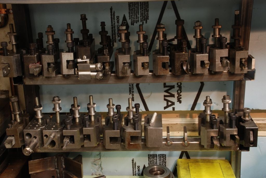

The Typo A size from the Italian copy do fit the Dickson tool posts (of the right size of course)
I can see someone moving to the multifix holder as they have the advantage of indexing, the Dickson holders do not. Its actually not at all a bad price for Dickson, I watched for awhile before buying privately and $200-400 US seemed the norm for ebay selling prices. If you need/want one, 300 Cdn going to be hard to beat

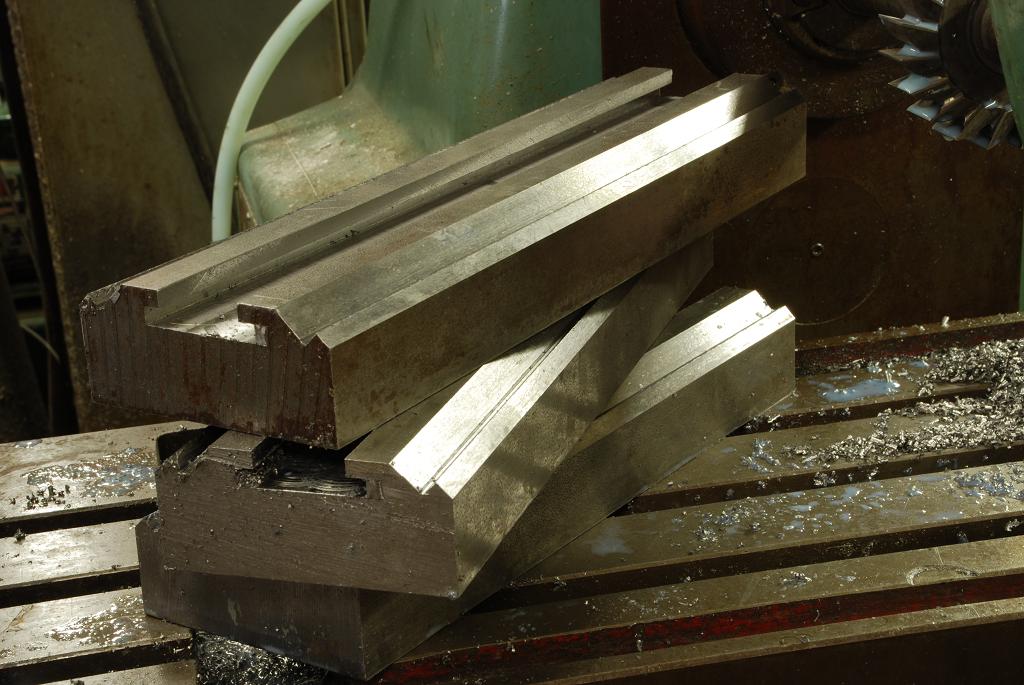

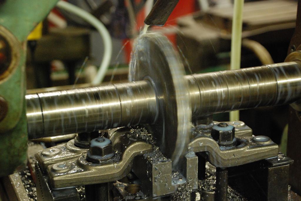

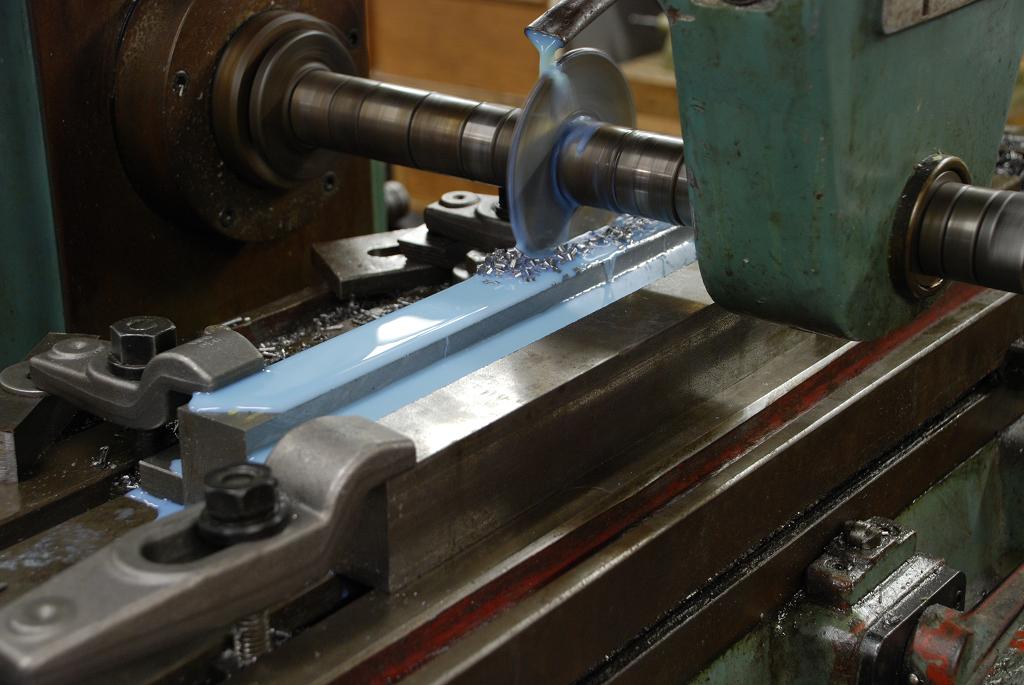

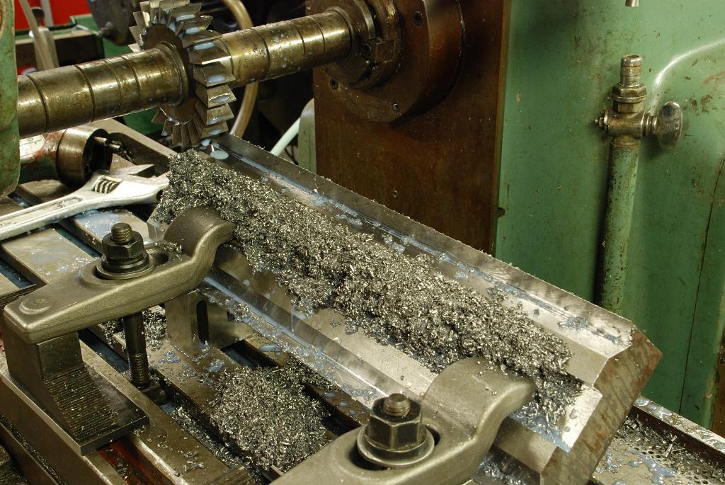

Where the Dickson shines over the multifix is the ease of making the tool holders.....I like lots of tool holders and don't like paying much. some photos of making holders
Edit, didn't mean overwhelm with so many pics...I thought would get links not images

How does one make a T slot on a horizontal mill?
I did it in the vertical mill as its easier , or at least more visible, and didn't require the horizontal's umph. To do it in the horizontal, just rotate everything 90 degrees. Workpiece clamped to the table on its side and the cutter held in a collet or tool holder in the spindle
