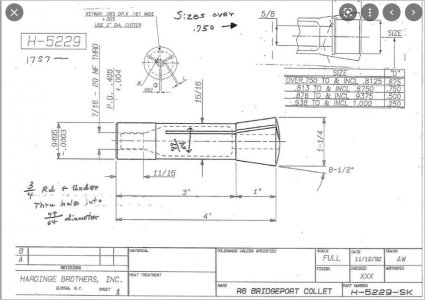

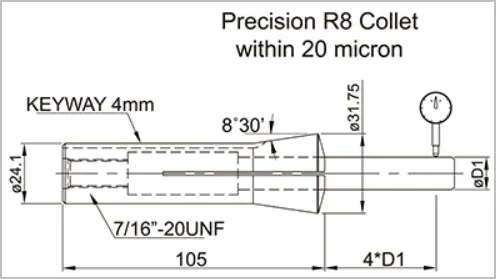

Curious, I've never seen a spec for how much shank depth anR8 collet is supposed to have for a given diameter. The Hardinge sketch makes it look like a wider chamber than the ID so tool could be pushed up until contact to drawbar threads but maybe that specific to their line? I tried searching some tooling catalogs but didn't see a dimension. I can measure mine just guessing maybe 2" insert length in 1/2" collet bore? Is there a chance your drawbar is long, threading through & EM contacting? I think most of my R8 tooling has blind threads but its been a while since I looked at a collet up close.

This Particular collet is a Hardinge. It is old but is in good shape other than the internal ridge. It has a chamber that begins right after the external cone. About 1.25" deep. Your drawings match what this collet originally looked like. The ridge on this collet starts about 5/8 of an inch in.
A half inch end mill slips in with pretty much perfect fit and friction until it hits the ridge. With a medium amount of additional force, it will slip past the ridge and then slips easily again.
