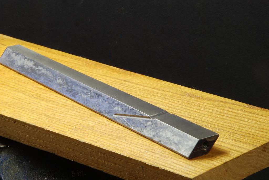

Just to be clear, my go to mini macro lens for my predominantly small stuff mounted to my ancient but reliable Canon T3i. It has an integrated 'mini' ring flash, 2 settings. But its basically dumb light conveniently orientated at lens axis, the operator/camera has to do the rest in terms of exposure, DOF.... When you get close to things, its harder to control indirect light. Well, that's a lazy mans excuse. There are all kinds of great ways to properly light small things, but requires a bit more time & setup than point & shoot. The classic ring flash has all kinds of settings but more money & its a bit clunky. The nice thing about TTL meter flash in any form is you can make more adjustments. Sometimes I'll just take my regular flash off, hold it in some more convenient position or bounce off another surface & use the cord/hot shoe. But yes, flash & metal don't typically give the most pleasing result without at least some softening.

Just to be clear, my go to mini macro lens for my predominantly small stuff mounted to my ancient but reliable Canon T3i is this. Has an integrated 'mini' ring flash, 2 settings. But its basically dumb light convenintly orientated, operator/camera has to do the rest. When you get close to things, its harder to direct indirect light. Well, that's a lazy mans excuse. There are all kinds of great ways to properly light small things, but requires a bit more time & setup than point & shoot. The classic ring light has all kinds of settings but more money & its a bit clunky. The nice thing about TTL meter flash is you can make more adjustments. Sometimes I'll just take my regular flash off & use the cord. But yes, flash & metal don't typically give the most pleasing result without at least some softening.
View attachment 38668View attachment 38669
