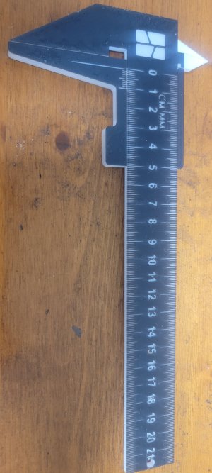

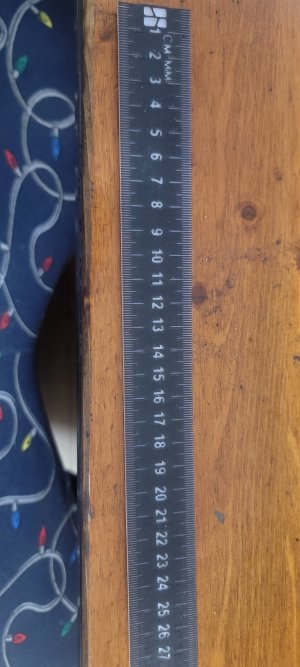

You've got me thinking Darren about printing scales with 10th and 20th" indications. I have various iGaging squares and prentice 3x combination set but they are all in the usual fractions measurements. I wonder if somebody has done that already and if there are any uploads on printables etc.
