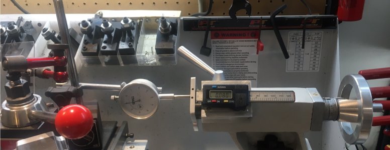

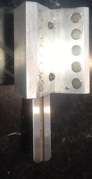

I was tired of doing the mental arithmetic of the never zero tailstock metric gauge on my BB lathe so I decided to use an old unused caliper sitting in the back of my Kennedy box. I was reluctant to drill the tail stock for mounting holes, so I decided to try a magnetic mount with 10 rare earth magnets and one tiny 2.5mm pin that only goes about 2mm deep into the tail-stock.
A little rough around the edges but seems to work well.

What the heck is the dial indicator all about? Calibration?
How is the Caliper attached to the corner block?
Does that pin sit in a drilled hole in the tailstock?

Yes the dial indicator was just a reality check.
I drilled and tapped two M3 holes in the back of the caliper case and then mounted the caliper to a thin mounting plate, so the assembly could then be mounted to the block, via the plate. In my haste I made the plate shorter than required so that the plate to block mounting screws were actually too close to the caliper body for the screw head to clear the caliper body for the top two screws, oops. So I countersunk all four holes and then drilled two larger holes in the block to provide access to the two M3 screws from the back.
Yes the 2.5mm pin passes through the block and sits in a very shallow (2mm deep) hole in the tailstock. So I did drill one hole but it's tiny and shallow. You can see the pin in the first image.
The funny looking shallow milled slot in the bottom left corner was required to clear a brass oiler that is on the top of the tailstock in that area.
