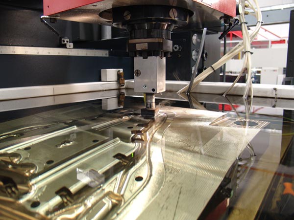

Sharp eyed Mr. John Nielson @johnnielsen noticed one of pictures said WEDM - ie Wire EDM. Or wire electrical discharge machine which is what that type of machine is commonly called in North America.Repairing the one you bought a smile looks like a big big project. We have a member making an EDM from scratch. I don't know of anyone else who has one of those in the forum.

It is an EDM cutting machine, about the translation software problem ------- does not need to cut the wire.
I'm not sure I can fix it, but I'm trying. Electronic circuits are not my good, I can only try not to destroy its main circuit.
