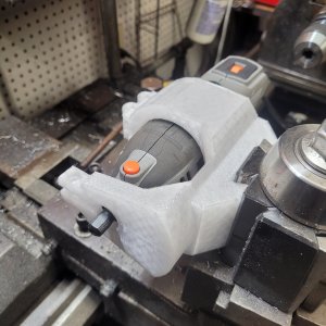

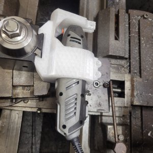

Just thought I'd share cuz it's cool how easy a guy can prototype ideas
I don't personally own a printer. But my brother does.
Using something called "slicer" ? I think...he took the measurements of the tool itself, the negative of my BXA tool holder holders, and a similar design on Thingiverse...and came up with this.
It's amusing, I didn't see it til now...but we didn't incorporate a height adjuster
Oops!
I also just thought of an additional feature to rotate it...
