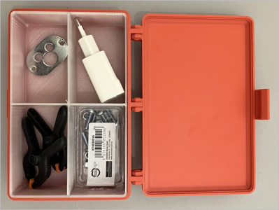

I have noticed more than a few of these hinge type boxes which, if I understand, is a single plate print. I have yet to try a download, but just wondering if anyone has experience with the print & end result. Does it print with support in between the male/female hinge surfaces, then goes crunch the first time you operate the hinge (breaking supports) & thereafter moves freely? (Which mitigates adding roll pins or equivalent as hinge pins).
One of the very first things I designed and printed when I got my first Anet printer was a simple print in place hinge. There is no support, just clearance in the cad model between the two part. Essentially leaving a gap big enough that the filament wont bond with the previous layer. I think I settled on 0.25 for mine, but I can't remember it's been a while. There are models you can download that have various features designed at various clearances so you can test your own printer and settings so you can easily achieve your desired effect. I think I printed a few different hinges at various clearances before finding a sweet spot where the hinge worked.

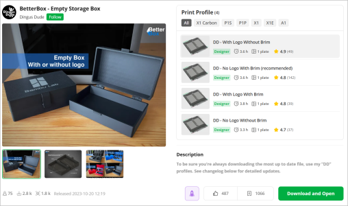

Ack! I found that model in Bambu Makerworld. When I tried to click it to get a link, it launched itself into my Bambu Studio Slicer, so still don't have the link & now I don't see it. Now I cant recall what specific search keywords I was originally using.
I tried again with 'hinged box' & even more came up like this, generically similar. Maybe I will just find a small one, download & try. Mostly I was interested to generate one on my own. This is still a confusing thing to me. If the box & lid are 2 separate bodies in CAD (with clearance between pin & hole), do I assemble them within CAD so they are spaced accordingly & then somehow import that assembly into slicer to preserve the orientation as a single build plate? I still don't see how it could print without supports. Maybe I should just focus on a hinge first LOL.

@Dan Dubeau I printed your hinge model laying flat like this. Very cool. It did not I suggest supports which I kind of understand now looking at the sectional slice, there is always infill material present but it just omits the clearance gap which is of course what you want for a hinge. I'll have to replicate this workflow in my CAD modeler, opens up a whole new world.

Awesome. How did the clearance come out on your printer? Did it take a light snap to free the hinge, or did it come off already free?
A tiny crackle & it rotates perfectly free. Well, as smooth as can be expected by printed striations of what are theoretical round parts, axle & hole. I didn't realize till I printed it, has an integrated stop profile so it's 0-180 hinge. My setting is 0.2mm on 0.4 nozzle. I'd take a pic but I'm using black filament & doesnt photo too well. So I think the basic design could be adapted into a single print box & lid like the example pics. But I'm going to make a little tester that uses say M3 roll pins just for comparison. Extra parts but maybe smoother action? Thanks Dan!
