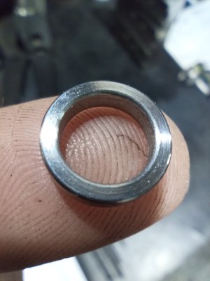

Not princess auto. Here is a bushing I made today. Anyone could buy them cheap but the customer needed good ones with a mill certificate so I had to machine them myself.

Alex, what's a mill certificate? I'm assuming it is a signed doc stating the part was made by an operator with a certain (verifiable) degree of skill and within spec?
Several places that sell metals will provide sheets, some upon request, some always, some may charge a bit. I checked the box once & got a half inch stack of papers. Usually if its to some standard like ASTM or whatever its just the same composition information, but sometimes it states the mill/supplier it came from.

It is much simpler than that. The mill certificate is a document that stays with the parts through ever step of the manufacturing process. It contains information such as; material type, tensile strength, country of origin, and what standard it was tested by.

You need a certificate for applications where a mystery metal is not acceptable. Such as when a human life my be put in danger.

Yep, I get those a lot running steel or aluminum. Basically just someone guaranteeing that what they think they are buying, is what they’re actually getting. Never really read one that close but I get the gist of it
