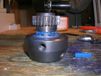

Well..... I'm still chasing the down feed slop in my mini-mill.
Seems the mesh between the down feed rack, and the rack pinion gear are the biggest culprits, followed by the helical gear and handle seat mesh. I want to see if a liberal application of powder coating to those parts tightens things up.

This is my niggle.
In order to raise the tool off the work piece requires a full 0.055" reversal of the fine feed dial. That's almost a full turn.
Today I shimmed the gear rack out 0.02" and that reduced the play to 0.04" A good 0.02 of that is the mesh between the helical gear and handle seat teeth. I can actually poke the tip of a x-acto blade into the gap present between the teeth of helical gear and handle seat teeth, so there should be some gain by tightening that up. One solution offered up on the web is to peen the tooth faces thus raising the metal some. That's where PCing the teeth came to mind and I attempted that once already but with not having a PC gun the coverage was poor.
I would be happy getting this down to 0.02".
I'm open to suggestions.

Spent the entire afternoon analyzing this thing.
0.015" can be attributed to the rack and pinion mesh.
0.015" can be attributed to the worm gear and helical gear mesh.
0.01" can be attributed to the helical gear and handle seat mesh.
Member janger has offered to PC for me, so I think I will attempt coating the handle seat-helical gear-worm gear and see where that takes me.
Got nothing to lose by trying.
Just need to find the time to T up with john now.

I would try the liquid steel suggestion , JB weld comes to mind or, I think Loctite sells a product to repair splines & shafts that have wore loose.
I would clean one of the gear bodies very clean of anything other than very bare metal and very lightly cover the other gear with a release agent ( I have use Johnsons furniture wax ), smear a liberal amount of whatever compound you choose on the clean gear and carefully join the two pieces, metal to metal on one gear face and metal to compound on the other.
