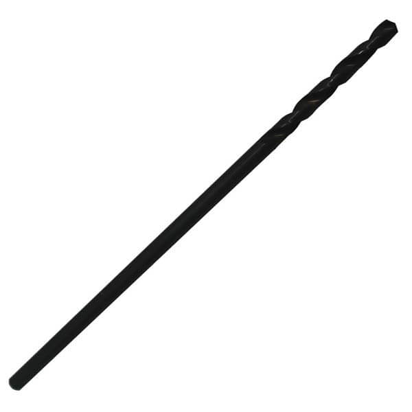

I have the same kit, about 2 years old as well... Still in the box. How do you plan to drill the main bearing cap holes? When I first looked I thought machining a block with holes as a drill guide would be best. It needs a long drill to reach

I have the same kit, about 2 years old as well... Still in the box. How do you plan to drill the main bearing cap holes? When I first looked I thought machining a block with holes as a drill guide would be best. It needs a long drill to reachView attachment 59670
Ive thought about making a drill extension, but with a quick look it doesnt look like there is enough clearance. Ive also been thinking of drilling through the base, a normal drill bit would be long enough, its just a matter of locating the holes. I think its a feature that didnt scale well to the model, and no one put much thought to it. What ever plan i go with there will be pictures of the outcome

If you add up the math for the bearing cap hold down holes there is just enough room to sneak a 3/16 rod down from the top, in a perfect world anyhow, i did have to file a little bit of the casting, and widen the bolt pattern by 20 thousands, tapping was another story, there is 0 room to get a tap handle of any kind in there, i held the tap with my fingers and turned the tap with a pair of vise grips with the whole arrangement in my lap
@ShawnR the hole size called is a #50 (.070) for a 2-56 screw, unfortunately to small for those long bits
it was a pretty simple operation to make an extension, chucked up a piece of 3/16, drilled it out with the bit, then crazy glued the same bit in the hole (the picture is the second crazy gluing....didnt quite get it in before the glue setup)
