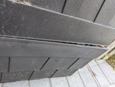

Best way to repair the top of this plastic shed? It's the roof peak that folds over but the seam has torn apart at both ends during transportation. It's hanging on at the centre and the two sides leave a gap that doesn't want to come back together without some force.
I have a plastic shed that I suspect is very similar to yours. The folded corners of the wall are only one thickness unlike the majority of the double sided blown structure. Those corner folds cracked out on me for no good obvious reason. I bent a 90° corner out of 20 gauge sheet metal that covered the corner from floor to roof. I then screwed that directly to the walls. I then loaded the floor I made and building attached to it on a flat deck and moved it 5 miles down the road. It handled the move and it has been a fix for it.
I think I'd do a similar fix for your roof but put the new metal piece over the outside top.
