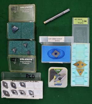

A guy was selling a whole bunch of inserts that he got from an auction. I picked up a whole bunch of laydown threading inserts, UN60, M60, UNJ, Acme, and buttress. Also some CCMT, DCMT. The packs were all mixed in several cardboard boxes, so it took a while to go through them. A lot of the inserts in there were really old stock, or stuff that I don't have tooling for. But I found a few gems.
PCD inserts, Polycrystalline Diamond inserts, for aluminum.
CBN inserts, Cubic Boron Nitride, for machining hardened steel (60-65HRC)

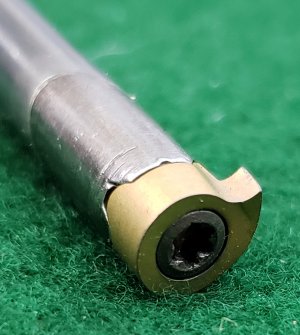

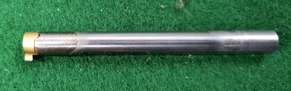

Also a 6mm solid carbide boring bar with carbide inserts at the front. You can get threading, boring, back boring, grooving heads.

I bought a TNMG CBN insert figured I'd give it try. I have a chrome hydraulic cylinder rod that I'm going to use for a project (haven't yet). When I ordered I thought it was a box 10 well to my surprise it's was only for1 insert @ $12.59 delivered. A little pricey. We'll see how well it works.
Usually, those CBN inserts from Sandvik or Kennametal are $130.00 each for single sided inserts, and $230.00 each for double sided inserts. And minimum order of 5.
Well in light of that I guess I got deal. By the way the insert is double sided so a total of 6 edges.
