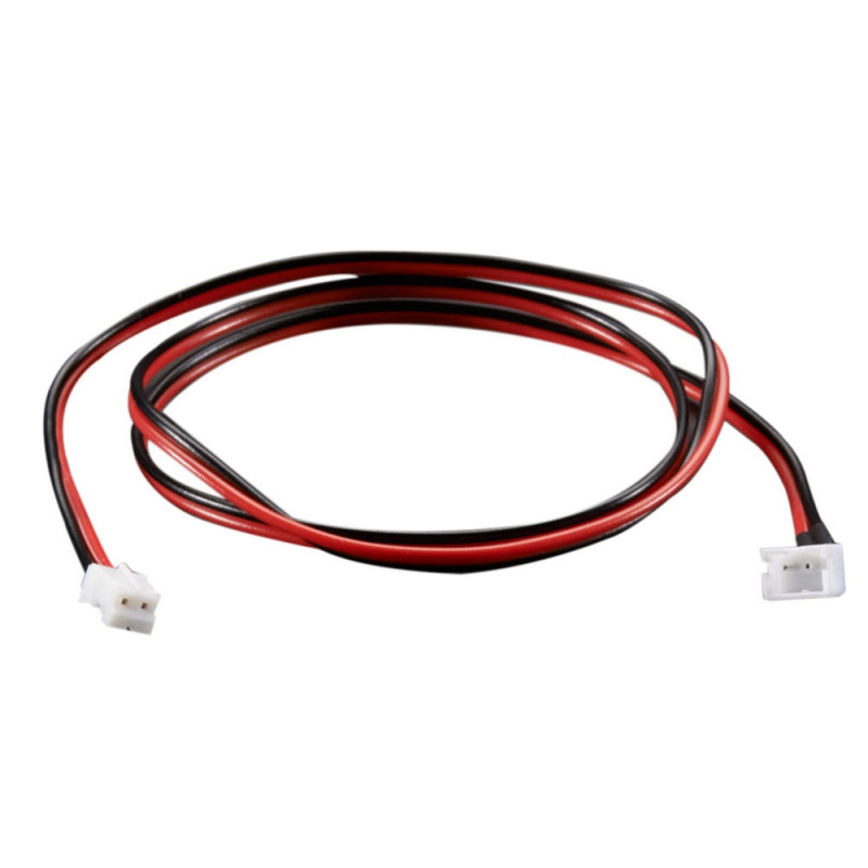

Currently in the process of getting a VFD put together for my mill. While piecing this together, I want to change the tach display power source from battery to DC via a printed circuit board 240VAC/9VDC power supply.
Ordered one from Amazon, it arrived & the problem I'm having is finding plugs to fit the sockets on the board for power in and power out. Looking at the specs the power in socket has 2 pins on 5.08mm centres, the power out socket has 2 pins on 2.54mm centres. I've checked Amazon and the only plugs I can find w/ 2.54 centres are like these ones, which look like they may fit. The only plugs I can find w/ 5.08 centres are like these & they don't appear to be close to fitting.
I've unsuccessfully searched the ad for seller contact info in the hope that they could recommend a source.
Anyone out there have a clew about these things?
TIA.
Standard pitches are 0.1" and 0.2" which is where the 2.54 and 5.08 comes from. You might find more search for those pitches If amazon doesn't have what you need, try Digikey or Mouser. Fantastic selection and service, next day delivery and free shipping for over $100.
My guess is its an XH (a size/version of a JST connectors), and that this would fit. Get something like this with the leads or you have to get a kit and crimpers

Well, possibly. I took a closer look at the circuit side of the board and traced etching connecting both plug receptacles to a pair of holes for power in & power out locations. It appears I'll be able to solder wires directly to the PCB & obviate the need for plugs.
Feel kinda foolish that I didn't notice this at first blush.
