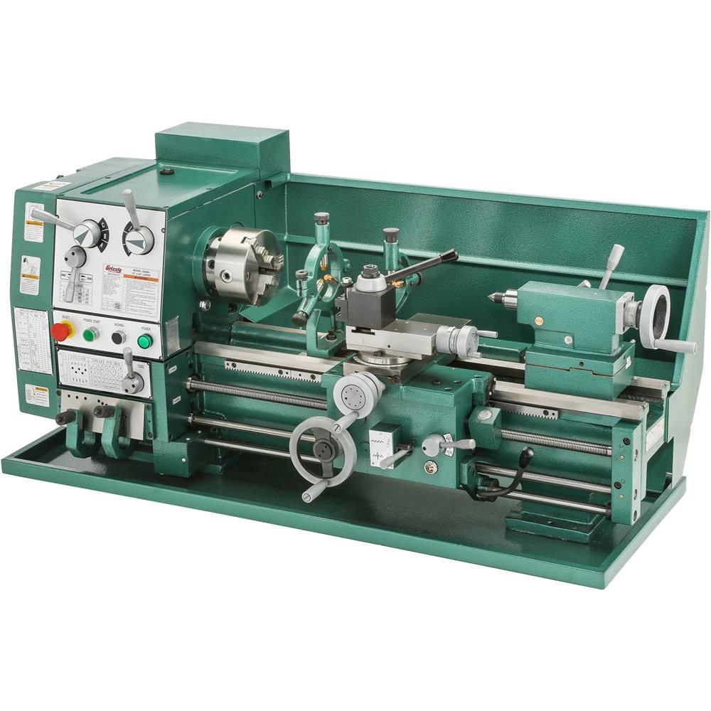

My current machining is mostly aluminum, and the B2227L lathe I have has geared spindle so it’s easy to change spindle speeds. I think the PC-36 style lathe has a very simple belt system, so it’s likely wouldn’t be a deal-breaker for me. I’m holding out for the Holy Grail of a small lathe with geared spindle, separate threading and feed drive shafts, and quick-change gearbox. Grizzly used to bring in a 12x24 cut-down version of the common 12x36, but whenever I see one I’m too slow on the draw and someone else buys it.

The Grizzly G4002 (discontinued) was a short bed version of the G4003, similar to the BB CX707 12”x36” but only 24” bed. Almost the same length as the B2227L, but twice the weight. And has a cam lock spindle with full geared spindle, geared feeds, power cross feed. All the goodies.
I see that the G4002 has a top spindle speed of only 1400rpm. Is that enough for your aluminum work?

They make that same lathe cut down even further to 12x16 and that is my holy grail, because I could actually fit it in my house with my other home shop essentials.
I've never seen one for sale in Canada though
