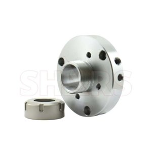

I have a bunch of the ER40 collets already but I would need a holder like this, yes?
That's for a mill (R8 spindle).
You need a collet chuck made for a lathe backplate (SHARS, couldn't find any on the Accusize site; can also find on eBay – Discount Machine Shop – for somewhat less):
The above has a set-tru (-ish) feature; you can get them without this for significantly less. You will need to verify the backplate required (SHARS/Discount Machine Shop can help with these as well
