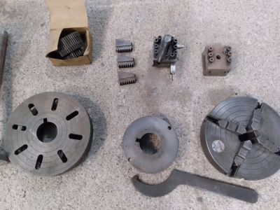

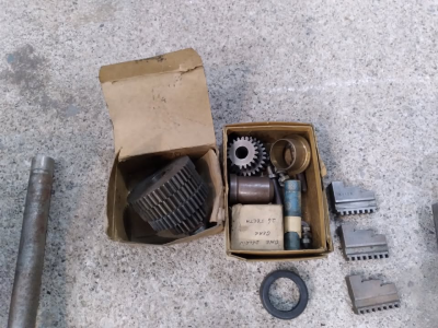

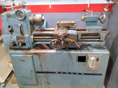

This little beastie appeared on marketplace with over an hour elapsed since its posting, so i figured it was a lost cause, but the seller did get back to me the next day and it was on !
So, I had a day before he was available to take a crash course on Raglan lathes .
1753235693836.png1753235720889.png1753235742173.png1753235747808.png1753235754343.png1753235761245.png1753235781176.png1753235789809.png1753235796410.png
I am bagged after loading and unloading once I got home, and will investigate the treasures in daylight. but some neat features:

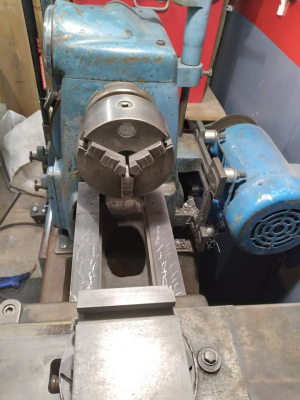

1) if the ways wear out, just bolt in some machined new ones!

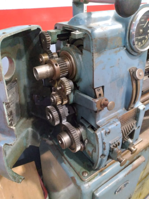

2) It has a variable speed head kind of like i think what i have seen in Bridgeport's
3) with the variable speed head it comes WITH A TACH!:D

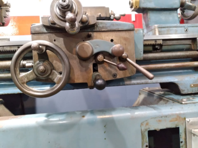

4) power cross slide and carriage
5) i think it came with the change gears for metric.
That is all for now , time for dinner

side note, I think those are 3c collets but i may be mistaken , anyone have an opinion? more pics to come this evening
Need more detail and/or better photos. Craig and Craig can dope it out for you when they are there.

I will check again, but I think the ways are flat bar with blind holes drilled in the underside and bolted to the bed, at which point they were ground in place to true up .
Might be an early version of gap bed. Can you post a photo of this?
found a reference in the brochure , point 5
Ah, I see. So basically, they used good steel instead of hardened cast iron. Most lathes just have cast iron, some have hardened cast iron (like mine), and your lathe takes that up a notch with high grade hardened steel.
