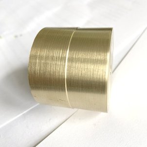

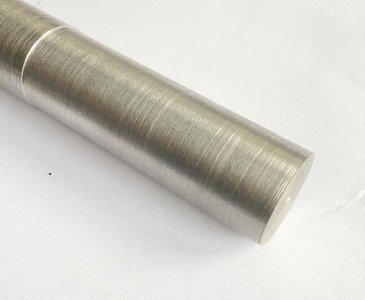

I was fortunate to be included in a HSS grinding example scheme that Hobby Machinst had. They sent around examples of three well ground HSS tools, but ground in keystock.
A general purpose tool for turning/facing, a knife tool for facing and thin work and a standard 60 degree threading tool.
On receipt of the examples. you were expected to grind a set of examples for yourself and send the originals to the next person on the list.
The 189-page thread is here. It is an excellent read and well worth the time. The originator, Mikey has since passed away but he was able to do some amazing work on his Sherline lathe using tools like those below.
