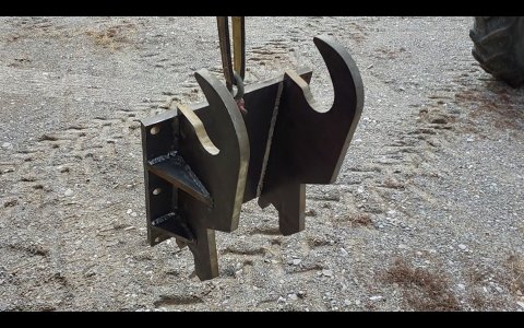

Found an old copy of sketchup on my old computer i was going through a few months ago. I did a course with it whenever i was in highschool. I started playing with it and kinda got back into the groove a bit. fast forward to me buying a jackhammer for our excavator and now needing a quick attach to hook onto it. company wanted $2k++ for a ready to go one. so i whipped up the bit in sketchup, emailed a dxf file to my buddy at the steel fab shop and have the bits for about $700. an evening of welding later and voila!
Probably not the best program for making drawing but in this case it worked out.
View attachment 87459View attachment 87459
A beautiful example of a HEAVY Fabrication !!
(Some Plasma cut plates and Heavy welding)
Reminds me of the products we made at COMAC in the 2000s.
Thanks! I'm really happy with how it turned out.
