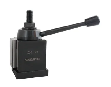

I spotted this:

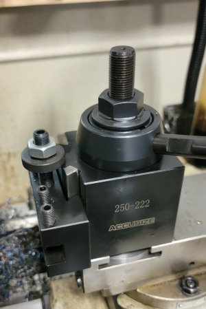

I've always wished that my BXA piston style was a wedge instead. So I bought it at a good price figuring there was prolly nothing wrong with it that I could not fix.

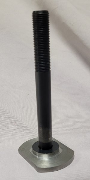

I'm guessing that whoever originally bought it didn't realize he had to machine the t-bolt to fit his compound.
It was a relatively quick job on the lathe and mill.

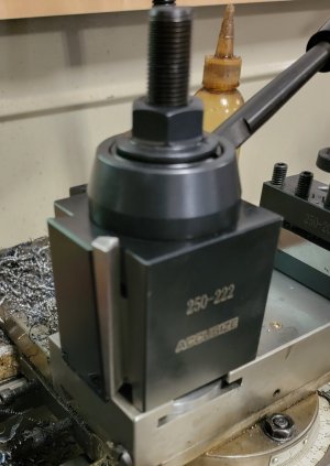

Here is is installed.
It fit perfect and works great. What I like most is that the tool height doesnt change when you crank down the wedges.
The extra thread on the TBolt will give me the room I need to install a second Lever to tighten the nut with.

Sorry for all the swarf in the photo. I didn't clean up yet after turning the nut. My mill is full of swarf too.
