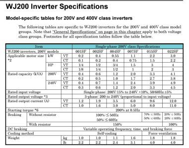

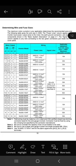

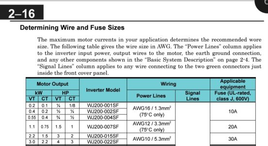

My apologies, the attachment I provided was for powering 3phase motors over 5hp, from single phase power.
You guys know a hell of a lot more than I do, but I just follow the manufacturer's requirements.
So for instance, in the specs for the WJ200 inverter, for a 2hp motor used in Constant Torque requirements, it suggests to use the 015SF inverter, at a rated output of 8.0a. And when looking at the Wire and Fuse Size table, for that inverter model, it suggests using AWG10 wire and a fuse no greater than 30a.
Ya, but Tom's motor is 1.5hp. The same chart says 12g for that.
As @justin1 implies above, the problem with oem recommendations is that they have to cover any and all possible uses. In the majority of cases, the applications are industrial with long leads (with associated voltage losses) and continuous loads like pumps.
For hobby applications with short wiring runs and intermittent usage, it isn't necessary to be so conservative. 14g is sufficient. But as I stated above, it certainly doesn't hurt to go a bit bigger if you have the option.
Well, 12g. for 1.5hp Variable Torque applications, or 1hp Constant Torque applications. But I honestly don't know the difference in our situations, so I always use the Constant Torque specs.
