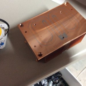

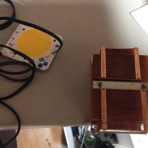

Thanks. Nothing specific. I am currently just learning to tap aluminum heat sinks. I am thinking of transforming an old stand lamp into an LED 40W stand lamp. The LED lamp is a circular wafer that I will screw onto a large CPU heat sink. Then I will need to find a rod that I will thread to fit the stand light base plate and screw into the heat sink on the other side; of course after tapping it too :)

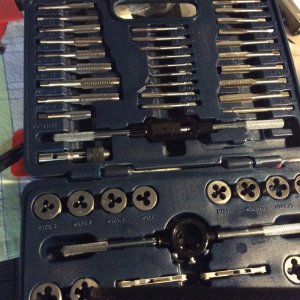

Thanks for the tips Peter. I like the spiral bit.I already have a tapping set that is not the spiral type. I did use cutting fluid and was able to tap 1/4 of an inch #6-32. I wasn’t able to go deeper. The bit would rotate in the nut. I am not sure whether I should apply more force to tighten the nut ..
I used my drill press for a steady entry and drove the couple few turns by hand. Then I finished the job with the hand tool.
Anyways I do not need more than 1/4 “ and I got the wafer installed. I cut the #6-32 1/2” screws I had to 1/4 using a dremel with a diamond disk

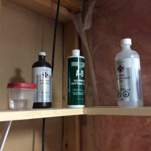

I've heard good things about A9 cutting fluid too.
But is the heat sink you are showing in pics not copper (vs. aluminum). Or is that just the part that mounts to your aluminum work? Copper can be even more 'fun'. It's a very sticky material. Everything I said about aluminum X2. I find WD40 works pretty good for cutting but I haven't done much deep tapping thankfully.
Another process that might be considered for sticky materials is roll (form) tapping. There is no cutting involved to make threads, its kind of a distortion process. You need a special tap & different drill size pilot hole & it involves some other considerations. May or may not be suitable. Lots of info on the net.

Yeah you’re right. It is copper, just didn’t think about it. Though most of my heat sinks are actually Aluminum. Still this worked I’ll stick to it for now. Thanks though for the tip
