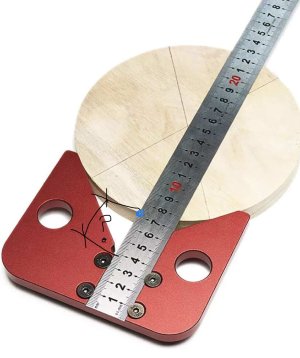

Ok, so I often need to lay out pipe sections, many times to locate diametrically-opposed outlet connections. Also have to check out-of-round and establish whether out-of round is within fairly sloppy tolerances. Size ranges from 0.405” o.d. to 12.75” o.d.
So my idea is to fabricate a very simple center finder with a direct-reading scale that compensates for the offset from the vee-angle. On my photo, the distance in black changes with each workpiece diameter, so either a bunch of trig to work out a non-linear scale to compensate for the offset. Or a sliding scale with a fixed zero point (blue dot) that adjusts for the offset.
Thoughts? Or does anyone know if such a beast already exists?
