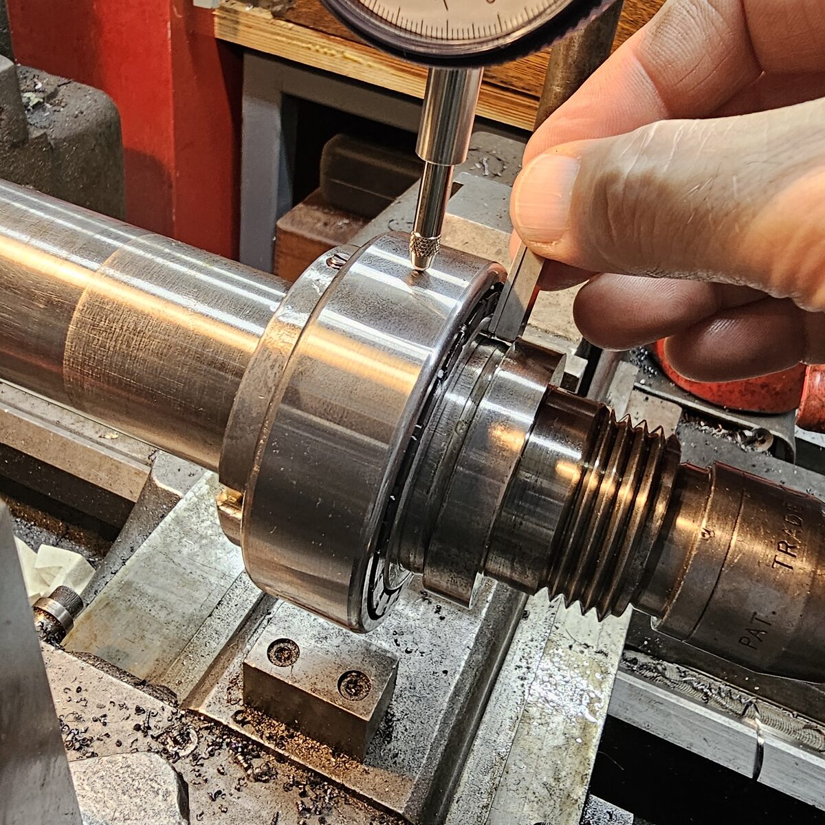

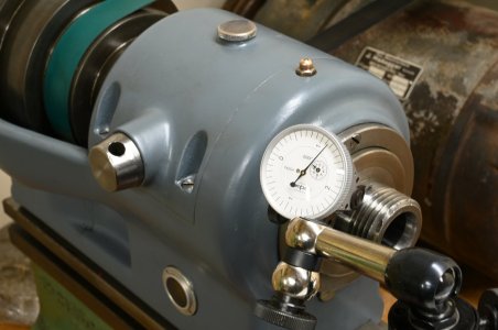

Anyway ..... enough whining, the subject is really about new precision bearing installation for a Schaublin 102 ..... or why I love the old, high quality stuff. Less than a micron runout on this 75 or 80 year lathe.
The bearing fit is obtained, to better than a micron, by driving a tapered inner race up on the taper on the hardened spindle shaft. How far you drive it up the shaft, expands the inner race and removes clearance in the bearing. I know! but it works.
I got this one so there is less than a micron run out, and you can't move the spindle shaft anything even approaching a micro by applying force. At the same time, rotation is easy and smooth.
The detailed process is shown here
And the video proof is here...... (not that you guys wouldn't have believed it, but heck, I might not have believed me 🙂 )

Nice job. That's truly one of those "flick the tip" type of situations to make sure the indicator is still working or touching. Nice reward for what I can assume is a great deal of skillful work to get there. Must be a real pleasure to use such accurate machines.
Hmmm. Never did it that way Dan.
I have always preferred to apply a bit of positive and negative pressure to the holder. That way I can instantly assess the workings of the indicator (smooth, intermittent, sticky, etc) without changing my setup or getting a false sense of security from a needle that works but has too much hysteresis either internally or due to my setup.
Another major advantage of flexing the holder is that it can reveal any flaws in your indicator setup that you wouldn't notice otherwise.
It also helps calibrate my physical sense of the forces at play in my machine and work.
Lastly it gives me that last minute verification of which directions mean what on my indicator. It always amazes me to watch machinists who don't ever seem to have that problem!
