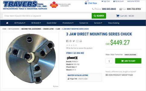

I have been looking for a new 8” lathe chuck. I was originally going to buy a Phase II D1-4 direct mount chuck from Travers.ca as they sent me a discount coupon by email. When I logged onto the site and put the chuck in my shopping cart it showed that I was getting a 26% discount to $332 off the retail price of $449. When I went to check out the price reverted back to retail. I clicked on the “talk to a sales agent” button to start an online conversation. The agent basically told me I didn’t qualify for the discount and even though I talked to a supervisor on the phone, they blew me off. I expressed my frustration (politely) and didn’t complete the purchase. Lesson learned, I won’t dealing with Travers again.

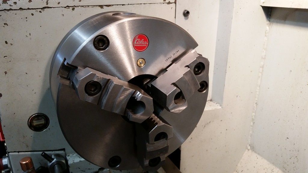

A few days later I got a sale flyer from KBC and they had flatback Atlas chucks on sale for $388 with free shipping for orders over $350 and under 50LBS. I ordered one and then ordered an Accusize D1-4 backplate from Amazon to get the free shipping. My thought was even if it wasn’t straight I could machine it in place on the lathe. When the chuck arrived it turned out to be a front mounting chuck instead of the rear mount shown in the flyer. I wasn’t sure if that would cause me a problem or not until the backplate arrived but I let the sales guys at KBC know and he told me if it was a problem I could return it.

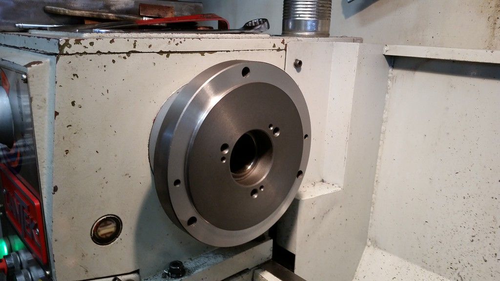

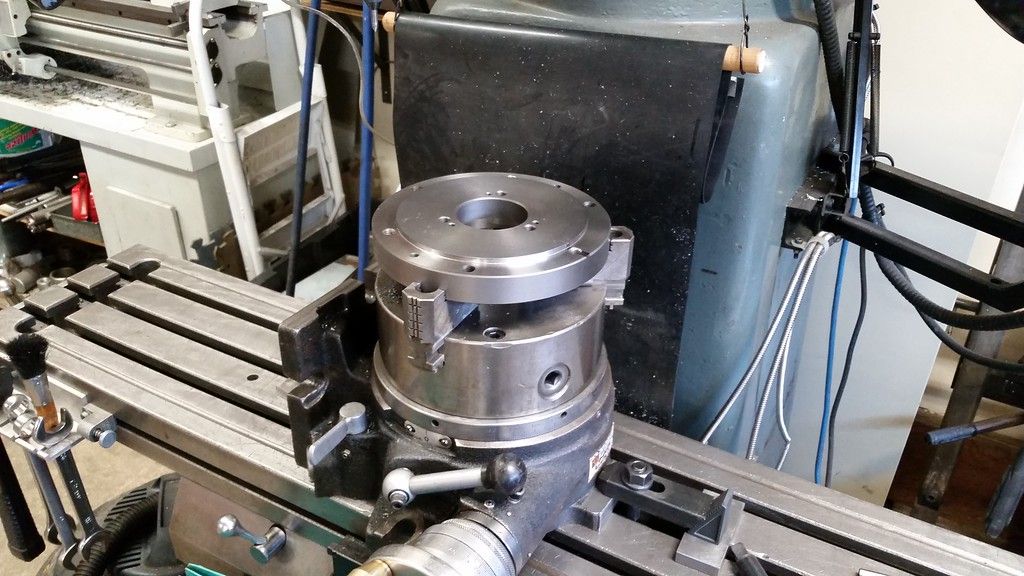

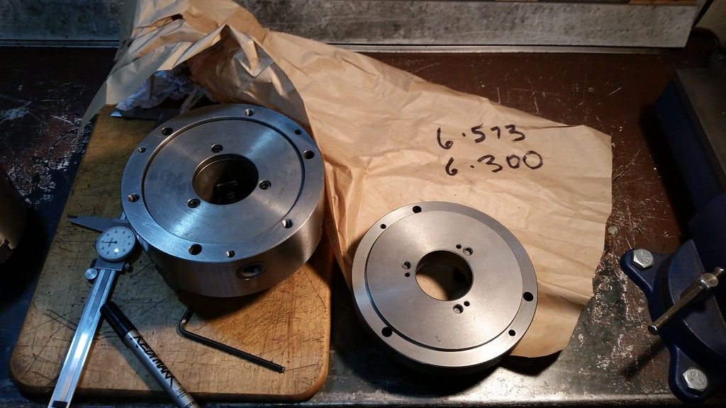

When the backplate arrived I first set it on the spindle of the lathe to check the fit onto the taper and it fit like a glove, no lateral movement but still sitting flat against the flat surface on the front of the spindle. I installed the D1-4 pins and remounted it to check the radial runout. I indexed it the three different ways and found it has almost no measureable run out. I wasn’t expecting that from Accusize. I had to machine the center projecting nose to the back plate from 6.573” as it was suppled down to 6.300 to fit the chuck recess and at the same time I took a skim cut off the mounting face to make sure it was flat. I left the nose of the backplate at 6.3005” for a slight interference fit into the chuck and then drilled and tapped the 3 holes for the mounting bolts. I set the backplate out in the -20 degree air for 30 minutes then it dropped right on the chuck and I torqued up the bolts. When mounted to the spindle I put a ¾” end mill in the chuck and measured the run out. It measures a little under .001”. Pretty impressive for an inexpensive chuck. I emailed Tyler at KBC and let him know the chuck worked out great and he still offered me a discount on my next order to make up for the incorrect listing in the flyer. I’m very happy with the customer service at KBC!

That's an awesome TIR spec. Its great when things work out, price & performance. That combo would be 2-3X the cost from a NAm or Europe country of origin. Sometimes you get lucky with the Asian stuff, sometimes it works the other way. But IMO you can see steady quality improvement over the years on average.

Thanks guys. I'm happy that this chuck buying experience ended up positively. It started poorly with my experience with Travers. I'm really surprised at the high quality of the Accusize backplate. Most of the previous Accusize stuff I've bought has been mediocre in quality and I actually returned 2 items because the quality was so bad. Maybe they are carrying better quality tools lately or perhaps, as Peter suggested, I just got lucky.
I have a very similar front mount 8" chuck on my Super Spacer that was made in Europe and it has almost no run out, I didn't expect the same performance from an Asian chuck. Time will tell if it stays this good but for now the .001" or less run out is repeatable every time as long as the chuck is tightened with the same pinion. I tried all 3 and using the one adjacent to the Atlas label gives consistently .001" or less run out. In the chuck manual the specs say it will deliver run out of .003" or less when tightened with the "nominating pinion". I get .003" or less when using any of the 3 but there is definitely one sweet one. My old 6" chuck shows this same characteristic with one of the pinions delivering the lowest run out. I have it marked on that chuck.
