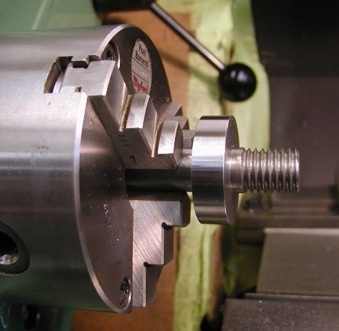

Never have I ever............ turned a piece of steel and gotten a mirror like finish like I get from turning aluminum with a new indexable insert tool.....until today!
I was getting set up to make a doodad to mount my mill DRO display and deciding which of my HSS, brazed carbide or insert tools to use on a piece of cold rolled bar. I've never been satisfied, often I'll get a decent finish, sometimes it turns out pretty good usually with HSS but I've never been truly happy with the result. It's usually the typical gummy steel part that's decent and functional.
On a whim tonight I took @Dabbler 's advice and dressed the flanks and nose of an indexable carbide insert with a diamond EZE Lap and was blown away with the result. Like night and day even after I've stepped up my HSS grinding & polishing.
OK, I'm a detail guy so: .030 DOC, .002 feed with a SOWA DCMT21.51-F2P insert, 1-1/2" cold rolled bar running 720 RPM so ~280 SFPM. The finish was actually better for the first cuts & not quite as good as the diameter decreased. The chips were coming off between brown and bright blue and HOT on the hand waiting to disengage the carriage feed (ouch!). It was coming off in chips too, not ribbons.

Ask and you shall receive! The part in question:
For scale, the threads are 5/8-11 - single point cut using the hand crank. EDIT: To my chagrin I found that the nice indexable tools I bought for threading and haven't tried out yet don't cover threads as deep as these therefore the fallback to a ground HSS tool. :(

I suggest you buy some DCGT CCGT inserts and try it on steel, Forget doing .030 DOC - But a nice shallow finish pass ( relative to your nose radius ) and a semi slow feed ( .003 IPR ) will yield the same. More or less.
At the highest RPM you can muster. ( relative to your part of course )
If you are chasing those tenths, Consider using a HSS shear tool, https://gadgetbuilder.com/VerticalShearBit.html
Ya........ I'm REALLY LIKING THAT CRANK! If I had made that part, the OD would look good too, but that would be a relief at the shoulder, not a nice fat shoulder.
Of course, somebody on here is gunna say something like just thread in reverse. But, that still makes a start groove. With your crank, the thread just ends - prolly even better than cnc. Yup, I'm a fan!

LOL! I can't take the credit for the hand crank, somewhere in the deep depth of knowledge of the UK Myford users someone invented it or re-spun it from something they saw. Very good idea though. I believe you can get a Hemingway kit for it.
I do have to put my thinking cap on though, mine can slip when I get into the last passes in deep threads like the 5/8-11. No notches or features on the tail end of the spindle to key to like you have though and I am NOT modding the spindle. I think it'll be a mod to the split angle.
OK, fessing up. The lack of relief groove is not by design, I had intended to do one but I also got the bug to cut the thread last night during quiet time so I couldn't run the machine. I hadn't cut the grove yet so I went ahead without it., lack of patience........turned out fine though. The part will pass though a bushing before it engages the threads so no functional issue.
