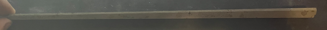

hoping to find someone in or near the okanagan with a surface grinder and mag chuck that could accomplish grinding down .400 off a piece of tapered gib stock roughly 16" long. willing to pay for your time
Thanks
the two ground faces are parallel to each other and the width is the same throughout but it tapers down the length of the gib. it would have to be ground or milled using a mag chuck with either gauge blocks stacking at one end to get it parallel to the grinding wheel/fly cutter or using a mag chuck attached to a sine plate. hope the pictures help

What am I missing here? The parallel surfaces don't need any special finish, they don't do anything (and .400 is a huge amount to grind.) It's the opposing tapered surfaces that are in contact. Is this just hogging off material to make a bigger gib fit?
Cast iron? I've milled and scraped tapered gibs and think grinding would be quite challenging. The reason is you must perfectly replicate the angle and fit between the two mating parts. That where scraping is so perfect - you use the existing surface to spot the gib. You say tapered gib stock, there is such a thing? Still, its going to need to be custom fit, i.e. scraping.
Apologies if you know exactly what you want, but can we back up a sec and find out exactly what the problem is? Missing gib or worn gib?
All good, the issue was I bought the lathe at auction with a stuck cross slide and apparently some mongoloid before me had decided that drilling it out was the first thing they would try rather then just taking the apron off and tapping out the gib lightly, so the existing gib had holes in it from both sides and was cracked. I ordered a new gib from the manufacturer but unfortunately they only supply gib “stock” that has the correct taper for all their lathes but needs to be fitted hence the massive .400” that needs to be taking off. I unfortunately don’t own a sine plate to get the correct angle and support while taking it down to approximate size on my mill but figured if someone had a surface grinder with such an attachment potentially I could pay them to hog it down for me.

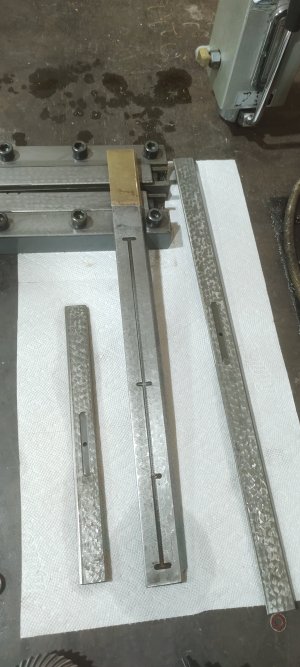

I've milled the angle before by setting up with mill vices and gauge blocks, but concede the length here makes it tough and super accurate milling (machine tool bearing fits) over that length is dicey to the say the least. Mill is to a thou (on a perfect machine) and I gib should be a much better fit than that. Fastening it to a piece of cold rolled, 3/4 x 3 or something, than clamp the cold rolled on a bunch of angle plates seems doable. If the angle is already correct, no need for a sine anything, just indicate across the top.
I still think you'll need to scrape it to get a good fit. I've done it by bluing the sliding part and inserting the gib. Get your rough dimensions on both ends using feeler gauges and mill almost to that leaving a maybe two thou for fitting. Wear comes into play on how good you can make the fit of course, but ideally you want a gib to have the same very small amount of clearance over the whole length of the mating surface such that with a thin film of oil it becomes pretty solid. That gives you rigidity and long wear.
All just imho..... there is more than one way to skin the cat.
PS, if its for a dovertail (vs boxway) you'll need to tip the head over. Easily done but creates another problem if grinding - you need a angle dresser and even then that means you can't traverse the work so end up with not the best grind, i.e. no traversing to spark out..
You got me digging through old files and I found some photos... so you'll have to suffer through them. I'm using scrap cast iron. For very large sections of durabar, they saw away the outer 3/4 - 1" because it can be full of cracks. I've got such a slab and use it slice gibs off of .... but occasionally you encounter such a crack and a piece falls out!
Measure each end will feeler gauges, calculated stack heights and set up with gauge blocks.
Here's slicing some off the slab .... I haven't a vertical bandsaw so just bury a thin horizontal cutter into it
