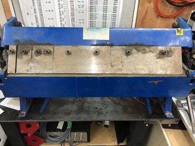

The $100 pan and box brake arrived today. Huge thanks to @Crosche for an excellent crate and all-around willingness to help a fellow member.
Super pleased with the brake. Needs a bit of spit and polish but it will do me just fine!

Thanks mate, I have to be totally honest... I bought it to make the parts to put the DRO on my Southbend.
But I have wanted one for ages.... right off the bat I need to make a drawer for my welding cart.

I use mine quite often, just yesterday made up a small aluminum box for one of my electronics projects.
Suggestions:
Make a couple of drift pins that fit the holes in the cams that adjust the finger spacing. Makes it much easier to operate.
Replace the chinesium cap screws that hold the fingers in place. Gets some nice Grade 5 socket cap screws. The chinesium ones will strip the first time you try to bend anything stronger than cardboard.

Thanks! I'm going to go through it and clean it up. I will replace the cap screws as your experience definitely parallels mine!

I have the 3:1 sheet metal machine. There are times where I'd much rather have the pan and box brake. To be truthful though, I find I nowadays 3D print boxes rather than fab them from sheet metal. Just lazy I guess.
I've been itching for a brake for a while, picked up a $40 6" vise mounted one today just to tide me over for some little boxes...definitely not as nice as this unit you got though!
