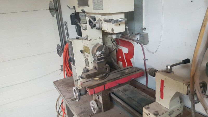

If you are willing to try to get by with a benchtop milling machine, you might consider a lathe/mill combo:
https://www.kijiji.ca/v-power-tool/...ftex-lathe-mill-combo-with-tooling/1477887369
Seller is asking $1,800. Assuming nothing is broken, that strikes me as being in the ball park.
As long as you are mostly working aluminum and are patient, you can get a taste for machining with a little combo like that. Heavy cuts in steel won't go well. Only you know if you have the temperament to deal with the machine's limitations.
If you decide to upgrade, you could likely sell it for roughly what you paid for it!
There you go! A perfect combo unit that fits your budget and gives you extra machining capabilities. As Craig pointed out, you probably could recoup most of the purchase price if you changed your mind about it down the road.

If I may, and this is entirely my own opinion on a combo machine...if your entire work forecast is for plastic, wood or aluminum then it might be a very good tool for you...however...
I owned a similar machine (a house of tools offering in mid 90's) for a very short time when I first entered into the hobby machining field...initial cost was a very attractive point to me, but I soon learned that the frustration of trying to cut anything harder than aluminum soon outweighed the attractiveness of cost.
The thing that soon becomes very obvious when you try to cut steel is the flexibility/lack of sturdiness of the bed of the machine that is magnified by the distance between the bed & the spindle c/l.. If you look at the supplied photo you will see the height of the tailstock & tool holder from the bed is quite tall...this distance enables a much easier opportunity for "twist" between the cutting tool & bed structure when cutting even mild steel.
I should add that all of us have a different "frustration threshold", and I'm, for the most part not easily frustrated when frugality enters the equation, but that machine got the best of me in very short order.
