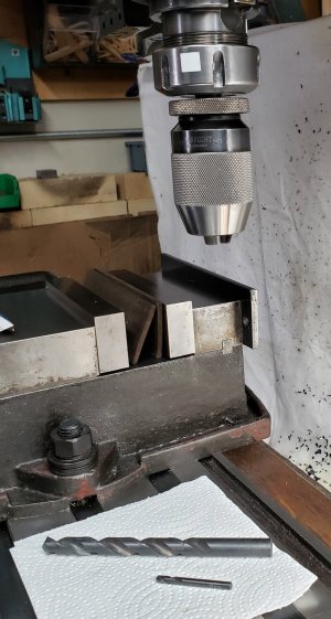

on drill chuck recommendations, I decided to measure a few things. I have an Albrecht 1/2" drill chuck with and integral 5/8" straight shank. I purchased it 36 years ago to drill holes using my Ex-Cell-O 602 milling machine. I've used it to drill holes almost every day since I bought it. If I only drilled one hole a day, that would be 13,000 holes. I decided to measure the run-out of the chuck. But the drill chuck is held in the mill with a NMTB-40 ER40 collet chuck. So I measured the run-out inside the mill spindle, inside the collet chuck cavity, the collet gripping a 5/8" shaft, and then the Albrecht chuck gripping a 1/2" shaft ( at close to the drill chuck jaws; 2" further down, and then 4" away). Measurements were taken with a Mitutoyo tenths DTI. See the results below. Not too bad for an old, well used drill chuck.

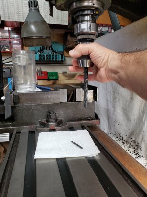

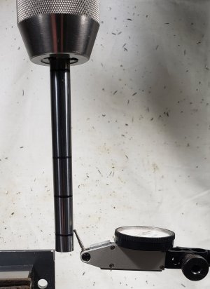

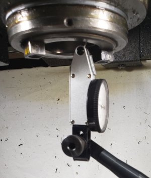

I did not try remounting the different connections ie. drill chuck, collet chuck, collet, shafts, but just made sure everything was clean and tightened to what I normally do.
The other interesting part is that the distance from inside the mill spindle to the furthest position I measured on the shaft held by the drill chuck is 10", which is a little more than 10x the run-out between those measured positions. Which leads me to believe,(though I could be completely wrong), that the connections/interfaces are quite accurate/precise/square.
Although not bulletproof, I agree. That a very reasonable and probable conclusion.

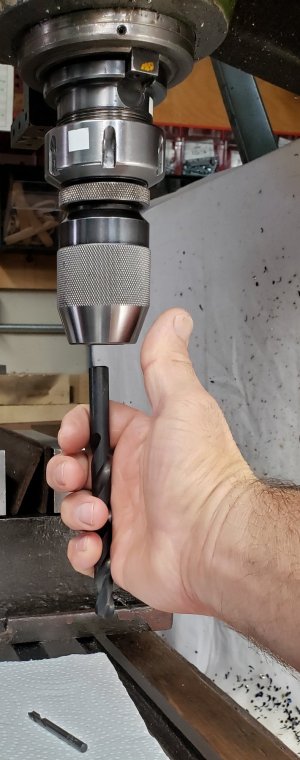

I'm just looking at the photo you posted here of your Albrecht chuck. How much of that assembly turns relative to the rest when you tighten down on a drill bit? Are you able to use one hand on the top half and one hand on the bottom to tighten/loosen the chuck by twisting in opposite directions?
If so, I'm even more interested in trying out an Albrecht chuck myself! That would solve my need for 3 hands.

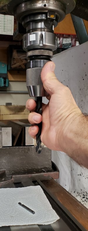

The top knurled ring is fixed with with the spindle. The bottom knurled body rotates to tighten or loosen the jaws. Yes, you could use two hands, twisting in opposite directions. Below are pictures doing it one handed!! I even did it with the spindle unlocked and in neutral. I did it as well with that small stub drill. No problem one handed. To remove, just a quick twist clockwise (viewed from above) and it's out.
Think of the keyless chuck for the mill as the equivalent of a QCTP for the lathe. I can edgefind, spot drill, small drill bit, large drill bit, countersink, power tap in lickity split time!

The only time my keyless spins relatively free on its own is when the machine is in neutral. Even the high speed range there is enough mechanical drag. Low speed or any gearbox type mill should be sufficient drag.
So right hand on the drill, left hand on the chuck knurl. Position drill & tighten enough so it doesn't drop out. (I like to rotate the drill itself within the jaws to feel contact & ensure its not somehow cocked in the jaws.) With drill temporarily secure, hold the brake & tighten to desired level. It takes longer to type LOL

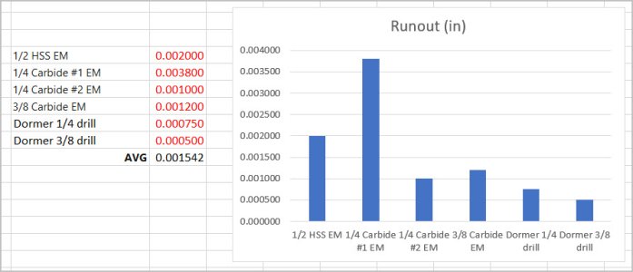

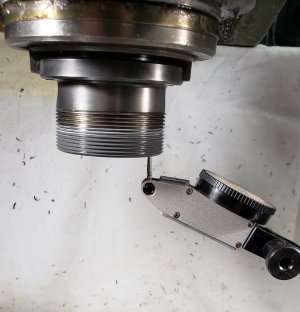

I managed to get out of bed today and went out to play in my shop for an hour. I decided it was a good time to test my drill chuck runout more rigourously.
My bare Spindle consistently measures less than a quarter of a tenth on my Mitutoyo 10ths dial test indicator. (0.000025) The needle barely moves. This is admittedly my best dial test indicator. The space between tenths lines is wide enough to be able to judge to a quarter tenth. I even decided to run the Mill at 5 Hz in low speed to see how reliably the dial indicator wobbled. It was pretty much bang on no matter where I tested it on the taper. Can't complain about that.
So I installed my R8 Drill Chuck. A Gerardi Spa Precision Chuck. That's when things went more squirrelly. I made the following chart.

These all seemed to repeat quite well even removing, rotating, and re-installing the bits. Therefore I suspect that most of the runout is in the various bits themselves. I was particularly struck by the difference in runout between my good drill bits and end mill shanks. I should have tried some cheap drill bits, but didn't. Maybe another time.
So I spent some time hunting around for a rod or something with better precision. Everything I tested was either bad or inconsistent.

The runout variation in runout is interesting. Hopefully your #1 is a bad outlier for whatever reason. I think the way to go for this type of thing is get some gage pins with defined specs. I've tried to find them individually but didn't land on a source. The import sets are reasonable cost for what you get, but they only span a certain range. Unless one does a lot of that kind of work, hard to justify.
Why do you say that Peter? It seems, reasonable to me. It's a shaft on an end-mill so I don't really expect it to be very concentric. There is also a flat ground in it for a keeper screw. I wouldnt be surprised if grinding the flat affected the concentricity above and below it.

Purely because everything else you tested in the chuck is significantly lower. Don't the other EM's have flats as well?
I don't know what you mean by a 'shaft on an end mill'.

Ah, I see. You meant 1/4" #1 Endmill. I thought you meant first in the list which is the HSS end mill. This first hss end mill has the flat. Neither 1/4 end mill has a flat.
My guess is that the first 1/4" carbide shaft is bent a bit. It is an Ali special. I could actually check it on a runout fixture I have. The only reason I tried two of them is because I was shocked a bit by the first one. I thought about excluding it from the data but decided it was better to just tell it like it was and test it again.

By shaft, I just mean the shank or the part of the end mill that gets held by a collet or a chuck. Basically, the part without any cutter edges on it.
