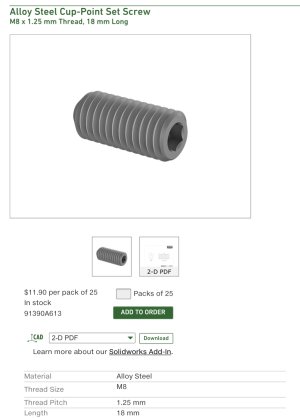

The question of balance is a good point. Was thinking about it, but didn't come up with anything. Filling the unused holes with a "headless bolt" should help with the out of balance issue. Something to think some more about.
Forest for the trees? My guess the big offset hole in the spindle mounting flange is going to have more balance effect than a couple of unfilled bolt holes. However, headless bolt? Busy Bee B2227 uses 8mm fasteners, a few socket set screws would do the trick.
I use these, but I’m sure you can find them at other sources:
