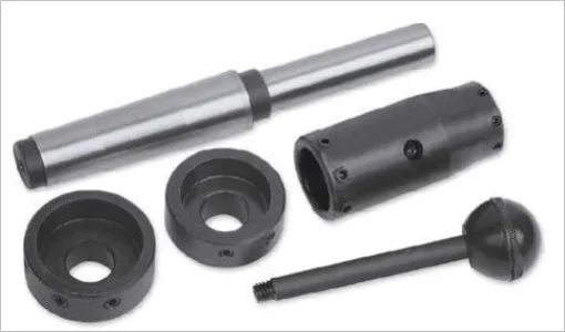

upload_2017-12-21_23-4-12.webp These can come with 1/2" straight, MT2 or MT3 shank and there is a channel on both sides of the holder to allow it to float on the shank.. Note that this isn't the cheaper shallow version where the cup-only gets swapped . Plus the barrel is knurled in case you want to grip it manually. Usually sells with 4 holder sizes but he also banged together a 5th size for me (2") which is a bit uncommon in this type of setup (usually only goes up to 1-1/2" die) .

So the shiny shaft segment sticking out of the die holder (middle picture), what diameter is that? Is that intended to slide in a MT shank with matching ID hole so you hold or turn tool by hand? Or is the shaft stub intended to be gripped in TS chuck & you advance the TS while chuck is turning?

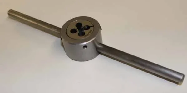

Actually I made a similar die body as those for my TS because typical die handles are so crappy these days. I have a cross hole for an insertable tommy bar for leverage.

The straight shaft in that photo is meant to be held by a collet or drill chuck (stock photo). I would image that you'd need a tommy bar with the straight-shank version and simply replace the guide pin with a bar.
The one I ordered is MT3 taper w/tang so that it can drop directly in to tailstock and then thread under power (tommy bar not required). Also, you could remove the pin and rotate manually.
I like that each die size is a separate dedicated part. I don't have a ton of die threading experience on the lathe but having a tough time visualizing hand gripping on the knurl on threads much above 3/8 dia steel (or maybe I'm a wimp LOL). I think with the MT tang & slot/pin mechanism this is meant to be advanced with TS locked down. Maybe that's a smarter way to go.
I've seen this (tang-less)Tommy bar style on Ebay but it has bolt-on adapter heads for larger dies.

manual holder turning = either starting the thread, backing the die off, etc...
- I just thought of another use: cleaning up a thread in a confined space so not much force is required but there is no room to swing standard die holder handles...you don't need the shank to use the holders like other designs.
Overall, the TS would be locked and the holder has a slot to float while keeping the alignment in check.
My biggest use is for making threaded studs and I don't like making 20+ passes to form a complete thread. Therefore, I used to resort to using a traditional die holder that I somehow managed to start off-square and then the stud has a slight lean to it. With this tool, I make a few passes with the lathe to give me a starting thread that is square to the rod and then do the bulk of the work with this holder.
On the tommy bar style (or die wrench for that matter) you can hold the handle with right hand & rotate chuck with left hand in neutral gear. Its slower but I do this to advance the die a couple turns, back off to break the chip, then advance again. I've seen where people power die-thread with the handle stopped against the lathe bed. But even with handle protection I personally don't want to risk gouging the bed as it slides. I agree, starting the thread perpendicular is half the battle.

Not a fan of 1) single guide pin design 2) "cups" that you add for size changes. Full-on individual holders w/dual guides are more rigid and you can swap the pin for a tommy bar, if you want leverage
