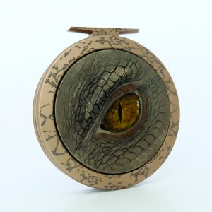

I can not find ANYWHERE reasonable for round stock and size.
Ya aluminum has gone through the roof the last few years. I'm lucky that I can ride on a big machine shop's coat tails near me that buys 5" dia. billet by the transport load. They sell me 6 feet at a time of 6061 for less than half what Metal Supermarket sells it for. But sometimes if I need smaller bits I'll use MS. When I do I ask for the certificates for it to make sure it's from Canada or the US as I got some from them once and it was from India! Lets just say I had to scrap all those parts after trying to anodize them.....was not good! 🙁
I have been interested in making a reel for many years but greatly lacking in skill as I am self teaching, and have to pay full retail for everything. Burning materials and tossing them in the scrap bin makes me sick just to think about it, we get so hosed on everything in Canada, I believe it truly goes to kill innovation unless one has deep pockets.
MM..
MM..
I would agree, but eventually you'd get to a point where you don't make mistakes, I say that and chuckle so I should rephrase that and say "as many" 😀. For me, if I do, the material can be repurposed eventually. That said I am paid to do that stuff so the money isn't an issue.
AHHHHHHHH, the dream job, say no more...... 😉
You could always melt it down and make individual sized pieces
I assume you are referencing this option to reduce swarf when taking it back to the scrap yard!
But, if you are referring to reusing the material that's a hard NO! Not only do you loose the materials temper, mechanical properties and change it's chemical composition but the material now acts and machines similar to cast aluminum full of voids, a nightmare to work with and hell no for anodizing!
