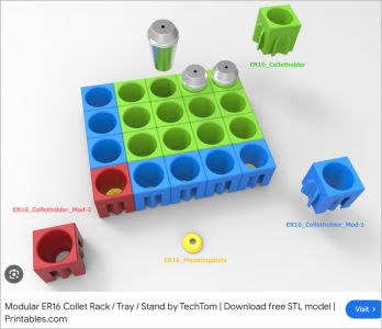

I find that if you search long enough, sooner or later you'll find a better version of what you thought was a great original idea but haven't even built yet LOL. The idea was a minimalist collet holding blocks that could index to one another so you can make any planform shape to fit a wider range of storage boxes. The tab system is a bit more complex than what I was envisioning, but I like the general idea. Maaaan, gotta get me one of those 3D printer thingies.

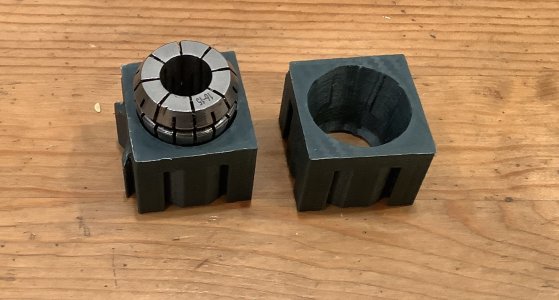

I like this one. Got a few items lined up to print.

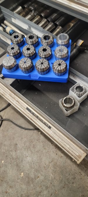

@Darren I think I've seen ones like your ER40 blue one. Is it shelled from the underside (= a uniform thickness around the base & collets) or basically a 3D solid?

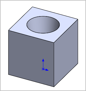

Well, although I like the fancy schmancy tangs, if they become a rather permanent assembly once engaged anyways, maybe just print single blocks & glue them together to whatever plan view assembly. And or glue them to a inexpensive base like cheapo 1/8" hardboard or whatever. This is a 25mm cube for ER16. The solid V=12,616 mm3. The 2mm bottom shelled one on right V=7,304 mm3 (rather ugly but I just wanted to see)
