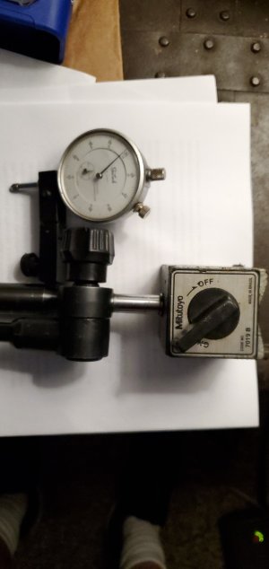

Mitutoyo indicator stand 7019B operation.
TorontoBuilder
I have two of these, but the wont tighten...
I hope it is just in need of hydraulic fluid.
Anyone have this model and a manual and parts list? They're discontinued and I can't find squat on them

This YouTube video shows a guy explaining a tightening fix of the exact same 7019B model. Starts at 5:00 mins. in.
Mitutoyo 7019B
Thanks, I found that too independently but I appreciate that you posted it here. Great resource.
Both my stands went from flaccid nonagenarian to viagra taking 40 year old with just 1cc each of oil. They're super solid indicator stands, so I wonder why they were discontinued.
You got it disassembled obviously. Were the hydraulic pistons difficult to remove because of aging O-rings, or just needed a magic touch to get them out?

Once I decided to have a legitimate go at it and got out my pliers with leather covered jaws they came out easily. The pistons spun easily, it was the vacuum that was holding them tight.
IF I was filing from scratch I'd use a syringe and care but in this case I just tipped out from a 4 liter oil jug that was almost empty. Easy Peasy. The rings were perfect. I suspect that these were sitting unused for a few years at least... I'll ask the next chance I get.
