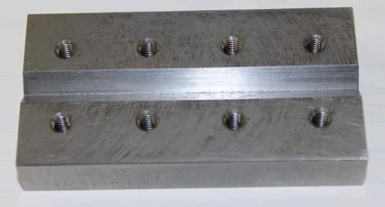

mini v block fixture

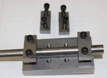

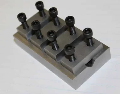

Nothing special - a rainy day project using up some scrap HRS. I needed a fixture with a few features that made using regular V-blocks less suitable. I need to hold round stock & machine different areas down the length, hence the series of hold-down clamp positions so I can keep the stock locked down & change clamps. I find those U-clamps on standard V blocks either in the way of the quill, or not holding securely during machining. I also need to orientate this jig in the mill vise at a specific angle top view (not shown but plan on using some matching front & rear angle blocks).
It turned out not bad I guess. A surface grinder would come in handy right about now :) I'm going to blacken it just for rust protection. The V-groove was a learning experience. I set the rectangular blank up in a standard V block & used an end mill distanced off an edge for centering. As you can see, the side mill side finished nicer than the bottom mill side. So next time I should either flip it to do both sides the same? I might actually make me a series of say 3 blocks with different V groove depths so I'm equipped to hold any progressive diameter like 2mm 5mm 10mm etc. Anyway, hopefully one of those homebrew tools you cant find in catalogs.
