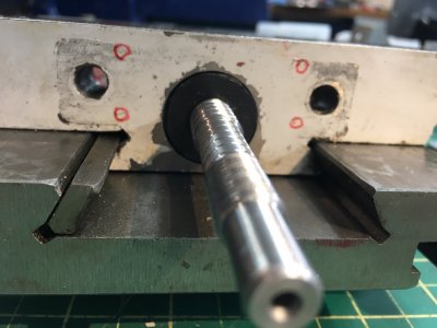

I'm in the middle of replacing the cross feed lead screw with a ballscrew to reduce the backlash. To do so I need to fabricate various mounting blocks to replace the originals. You would think during the design of something like a lathe that if you needed 4 holes in a square pattern to retain say a block you wouldn't randomly choose 9.74mm, when 10mm would easily fit just as well. Further you would not expect to have one of the holes skewed by 0.31mm for no apparent reason.
Moving on, next part with two mounting hole for a flange (image below), one mounting hole drilled 0.1" lower than the other so the flange needs to be tilted to line up with the holes, when it should be level. How does this happen? I imagined these were built on some form of assembly line with CNC machines drilling holes where they should be, not done by some hungover dude with a Black&Decker drill randomly drilling holes by eye.
I'm following drawings from a fellow that did the same upgrade on the supposedly better PM1022 lathe, some of the exact same defects he discovered are present on both lathes, and he has some defects I don't have and I have some defects he doesn't have. Definitely not made in Germany, Japan or Taiwan type quality.

Unfortunately hand drilled holes in some of these machines is just how they do it. One could argue its using lower cost labor but in many instances is just bad engineering & false economics IMO. They could have made a jig or fixture to better control the operation to make it much more consistent & probably quicker than the Mark-1 eyeball. Over time hobby machines from Asia are getting better on average. You can get decent machines but seems like they need to be specified / scrutinized / vetted by a reputable dealer. And those generally cost more. A machine from Germany or Japan, presuming they even make one, would cost you 10x more so choose your poison. Since we don't make anything like this ourselves & the raw material costs more than the finished part, options are somewhat limited.

When I was doing the CNC conversion on my mill I was shocked at how haphazard the holes were. Even when there was a bracket with holes on a pattern the mating holes in the casting were off.
So I had the same issue with Czech made lathe - this is more or less German level. The holes for mounting the gap in the lathe were very hard to replicate as they were... all over the place. Difference of like 1mm+
Since it does not matter during manufacturing how much "off" the holes are from perfect they are only roughly measured and drilled.
