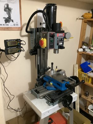

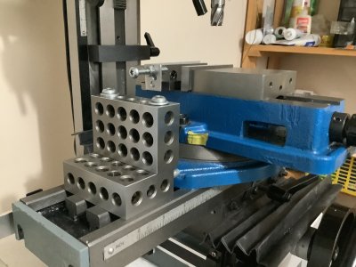

I went with a 3” Swivel Vise from Vevor.
I find it matches up pretty well to the KC-15VS.
(See the pics)
