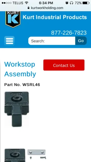

In the machines i used prior was a slot milled across the set jaw with a simple wedge (like old bike gooseneck) that used a tiny screw to lock in place ... this little guy right hereIMG_0294.webp
