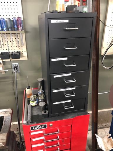

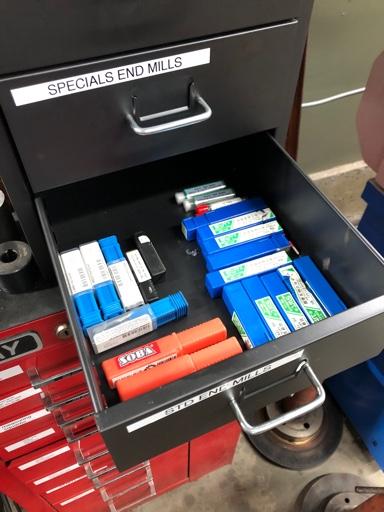

I bought these steel cabinets from ikea that are a nice size
They had sales last year when covid hit and offered free delivery for a while....

I've used 6 of these for a few years. One note of caution, if the drawers get heavy stuff in them the front pulls off. They also bemefit froma 1/4" plywood bottom reinforcement if you have heavy stuff.
